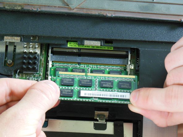

  13. Asus G53JW-A1 RAM Replacement: crwdns2935265:013crwdnd2935265:01crwdnd2935265:03crwdne2935265:0 Asus G53JW-A1 RAM Replacement: crwdns2935265:013crwdnd2935265:02crwdnd2935265:03crwdne2935265:0 Asus G53JW-A1 RAM Replacement: crwdns2935265:013crwdnd2935265:03crwdnd2935265:03crwdne2935265:0
    • To reinstall RAM, slide the chip back into the slot it came from, starting with the lowermost port. The port should be empty and tilted upwards for ease of access.
    • Push the card down so that the port rotates with it. The chip will snap into place.
  14. Asus G53JW-A1 RAM Replacement: crwdns2935265:014crwdnd2935265:01crwdnd2935265:01crwdne2935265:0
    • If you want to add additonal RAM, more ports can be found underneath the black plastic flap on the top side of the laptop, just under the keyboard. These ports behave the same way as the ones on the backside of the computer.
