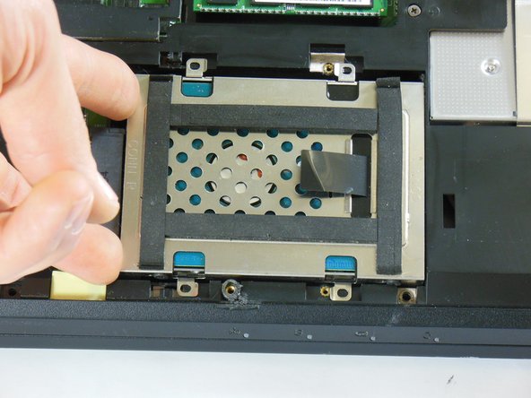

  11. Asus G53JW-A1 Hard Drive Hard Drive Replacement, Hard Drive: crwdns2935265:011crwdnd2935265:01crwdnd2935265:01crwdne2935265:0
    • Remove the two Phillips #00 2.5x4mm screws as located in the picture.
  12. Asus G53JW-A1 Hard Drive Hard Drive Replacement: crwdns2935265:012crwdnd2935265:01crwdnd2935265:02crwdne2935265:0 Asus G53JW-A1 Hard Drive Hard Drive Replacement: crwdns2935265:012crwdnd2935265:02crwdnd2935265:02crwdne2935265:0

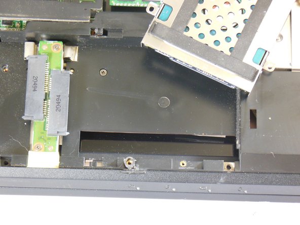

    • Slide the now detached hard drive out of the slots
  13. Asus G53JW-A1 Hard Drive Hard Drive Replacement: crwdns2935265:013crwdnd2935265:01crwdnd2935265:02crwdne2935265:0 Asus G53JW-A1 Hard Drive Hard Drive Replacement: crwdns2935265:013crwdnd2935265:02crwdnd2935265:02crwdne2935265:0
    • Remove the hard drive, lifting gently by the tab as shown.
