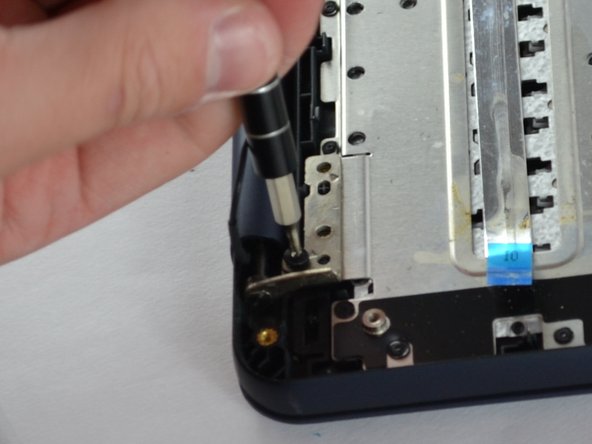

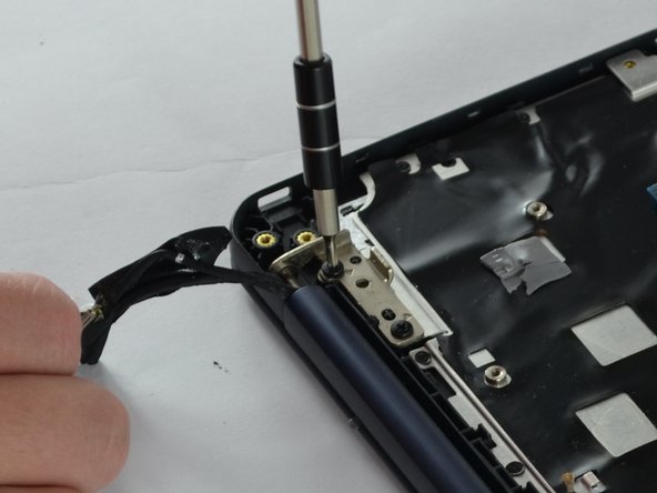

    • Unscrew the four screws using Philips #2 screwdriver that connect the screen to the inside of the case for the laptop.
  4. Asus EeeBook X205TA Screen Assembly Replacement: crwdns2935265:04crwdnd2935265:01crwdnd2935265:01crwdne2935265:0
    • Unplug the No-Fuss Ribbon connector of the screen from the motherboard.
    • Carefully lift the screen away from the case.
