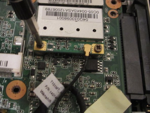

  7. Asus Eee PC T101MT Wireless Network Interface Card Replacement, Wireless Network Interface Card: crwdns2935265:07crwdnd2935265:01crwdnd2935265:01crwdne2935265:0
    • Locate the wireless NIC (network interface card).
  8. Asus Eee PC T101MT Wireless Network Interface Card Replacement: crwdns2935265:08crwdnd2935265:01crwdnd2935265:02crwdne2935265:0 Asus Eee PC T101MT Wireless Network Interface Card Replacement: crwdns2935265:08crwdnd2935265:02crwdnd2935265:02crwdne2935265:0
    • Use a nylon spudger to lift the wireless antenna from the NIC and remove the screws.
  9. Asus Eee PC T101MT Wireless Network Interface Card Replacement: crwdns2935265:09crwdnd2935265:01crwdnd2935265:01crwdne2935265:0
    • Remove and replace the wireless card.
