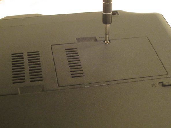

  6. Asus Eee PC T101MT RAM Replacement: crwdns2935265:06crwdnd2935265:01crwdnd2935265:02crwdne2935265:0 Asus Eee PC T101MT RAM Replacement: crwdns2935265:06crwdnd2935265:02crwdnd2935265:02crwdne2935265:0
    • Grab a drive adapter and a PH0 phillips head bit and use the screwdriver to remove the 5mm screw from the cover of the compartment.
