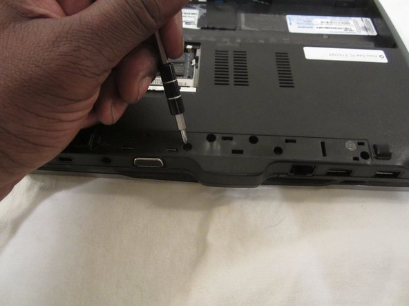

  7. Asus Eee PC T101MT Fan Replacement, Fan: crwdns2935265:07crwdnd2935265:01crwdnd2935265:02crwdne2935265:0 Asus Eee PC T101MT Fan Replacement, Fan: crwdns2935265:07crwdnd2935265:02crwdnd2935265:02crwdne2935265:0
    • Peel the black strip off of the back of your Asus Eee PC T101MT to expose more screws. Remove screws from the outside of the device case (ten 7mm screws and two 8mm screws).
