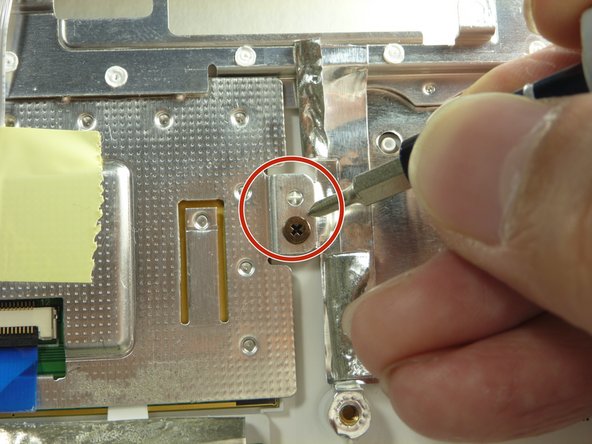

    3. Asus Eee PC 900 Touchpad Replacement: crwdns2935265:015crwdnd2935265:01crwdnd2935265:02crwdne2935265:0 Asus Eee PC 900 Touchpad Replacement: crwdns2935265:015crwdnd2935265:02crwdnd2935265:02crwdne2935265:0
      • Remove the two 4.76mm Phillips #0 screws securing the touchpad back plate.

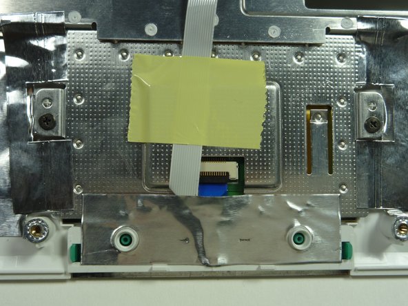

      • Remove the yellow tape holding the touchpad's ribbon connector with a spudger.
    5. Asus Eee PC 900 Touchpad Replacement: crwdns2935265:017crwdnd2935265:01crwdnd2935265:03crwdne2935265:0 Asus Eee PC 900 Touchpad Replacement: crwdns2935265:017crwdnd2935265:02crwdnd2935265:03crwdne2935265:0 Asus Eee PC 900 Touchpad Replacement: crwdns2935265:017crwdnd2935265:03crwdnd2935265:03crwdne2935265:0

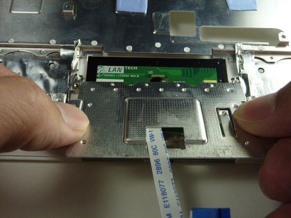

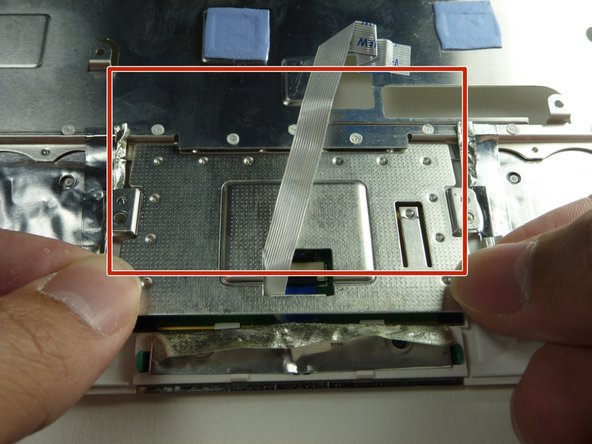

      • Use a spudger to lift the front edge of the touchpad back plate.
      • Gently grasp the edges of the back plate and pull towards you to remove.
    6. Asus Eee PC 900 Touchpad Replacement: crwdns2935265:018crwdnd2935265:01crwdnd2935265:01crwdne2935265:0
      • Lift the touchpad out of its placeholder.
