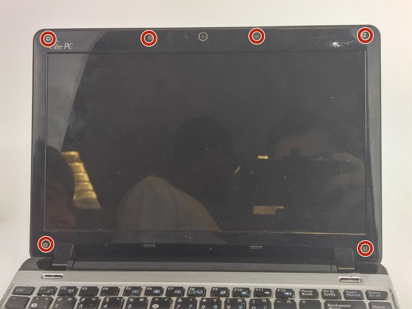

  4. Asus Eee PC 1201N Display Replacement, Display: crwdns2935265:04crwdnd2935265:01crwdnd2935265:02crwdne2935265:0 Asus Eee PC 1201N Display Replacement, Display: crwdns2935265:04crwdnd2935265:02crwdnd2935265:02crwdne2935265:0
    • Remove the six screw on the front cover by using the plastic opening tool. Then, remove the six 4.6mm screws using the J0 Phillips head screwdriver.
  5. Asus Eee PC 1201N Display Replacement: crwdns2935265:05crwdnd2935265:01crwdnd2935265:01crwdne2935265:0
    • Using the plastic opening tool, separate the over from the netbook.
