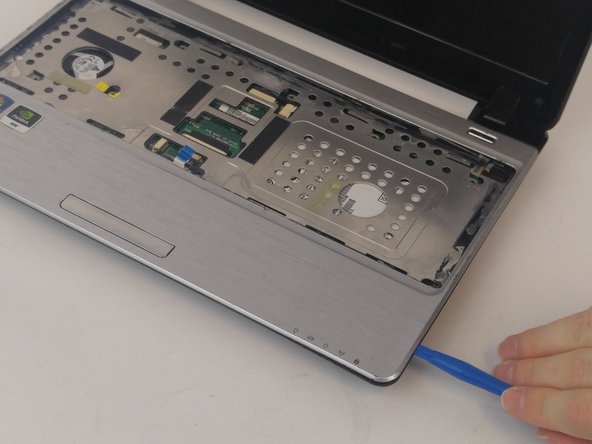

  7. Asus Eee PC 1201N Cooling fan replacement: crwdns2935265:07crwdnd2935265:01crwdnd2935265:02crwdne2935265:0 Asus Eee PC 1201N Cooling fan replacement: crwdns2935265:07crwdnd2935265:02crwdnd2935265:02crwdne2935265:0
    • Remove the ten 4.5 mm screws from cover plate using the J0 Phillips head screwdriver.
    • Remove the cover plate by sliding the plastic opening tool around the entire edge of the plate.
  8. Asus Eee PC 1201N Cooling fan replacement: crwdns2935265:08crwdnd2935265:01crwdnd2935265:01crwdne2935265:0
    • Pull the blue tab for the touchpad connector before removing the cover plate completely.
