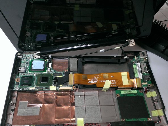

      • Using the plastic opening tool, carefully pry the top panel from the base.
    2. Asus Eee PC 1008ha Screen Replacement: crwdns2935265:02crwdnd2935265:01crwdnd2935265:03crwdne2935265:0 Asus Eee PC 1008ha Screen Replacement: crwdns2935265:02crwdnd2935265:02crwdnd2935265:03crwdne2935265:0 Asus Eee PC 1008ha Screen Replacement: crwdns2935265:02crwdnd2935265:03crwdnd2935265:03crwdne2935265:0
      • Lift the side of the keyboard.
      • Disconnect the attached ribbon located underneath the keyboard.
      • Place your index finger in the hole on the right side of the keyboard tray and lift the tray.
    3. Asus Eee PC 1008ha Screen Replacement: crwdns2935265:03crwdnd2935265:01crwdnd2935265:02crwdne2935265:0 Asus Eee PC 1008ha Screen Replacement: crwdns2935265:03crwdnd2935265:02crwdnd2935265:02crwdne2935265:0
      • Use your fingers to lift the battery and gently disconnect the wires from the base.

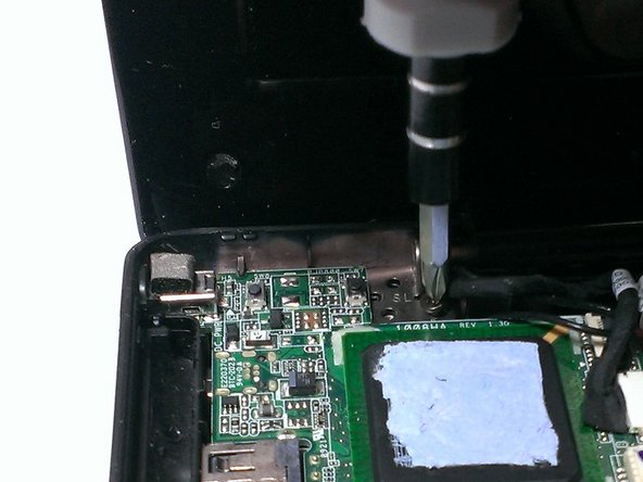

    1. Asus Eee PC 1008ha Screen Replacement, LCD Screen: crwdns2935265:04crwdnd2935265:01crwdnd2935265:02crwdne2935265:0 Asus Eee PC 1008ha Screen Replacement, LCD Screen: crwdns2935265:04crwdnd2935265:02crwdnd2935265:02crwdne2935265:0
      • Using the Phillips #00 screwdriver, unscrew the 4mm screws from the rightmost circuit board.
      • Carefully pull the circuit board away from side of device base.

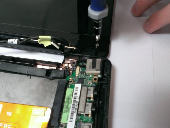

    2. Asus Eee PC 1008ha Screen Replacement: crwdns2935265:05crwdnd2935265:01crwdnd2935265:03crwdne2935265:0 Asus Eee PC 1008ha Screen Replacement: crwdns2935265:05crwdnd2935265:02crwdnd2935265:03crwdne2935265:0 Asus Eee PC 1008ha Screen Replacement: crwdns2935265:05crwdnd2935265:03crwdnd2935265:03crwdne2935265:0
      • Using the Phillips #00 screwdriver, unscrew the 4mm screws attaching screen to base from both sides.
      • Gently lift the screen portion from the base.

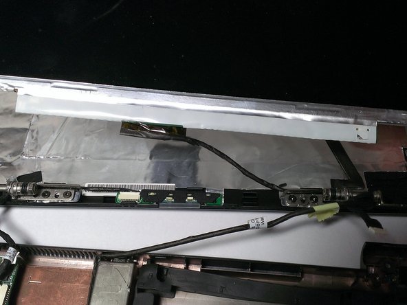

    6. Asus Eee PC 1008ha Screen Replacement: crwdns2935265:09crwdnd2935265:01crwdnd2935265:02crwdne2935265:0 Asus Eee PC 1008ha Screen Replacement: crwdns2935265:09crwdnd2935265:02crwdnd2935265:02crwdne2935265:0
      • Use your fingers to peel back the adhesive tape located on the back of the screen.
      • Disconnect the wire from the screen.
