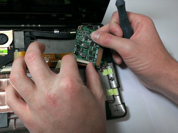

  4. Asus Eee PC 1008ha Graphics Card Replacement, Graphics Card: crwdns2935265:04crwdnd2935265:01crwdnd2935265:01crwdne2935265:0
    • Remove the two 2mm screws from the graphics card.

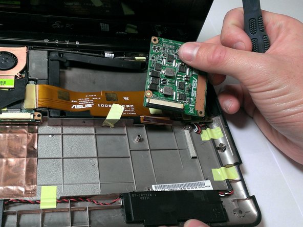

  5. Asus Eee PC 1008ha Graphics Card Replacement: crwdns2935265:05crwdnd2935265:01crwdnd2935265:03crwdne2935265:0 Asus Eee PC 1008ha Graphics Card Replacement: crwdns2935265:05crwdnd2935265:02crwdnd2935265:03crwdne2935265:0 Asus Eee PC 1008ha Graphics Card Replacement: crwdns2935265:05crwdnd2935265:03crwdnd2935265:03crwdne2935265:0
    • Flip over the graphics card.
    • Pull the black plastic locking mechanism towards the golden ribbon to unlock.
    • Pull out the ribbon.
