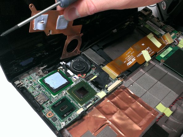

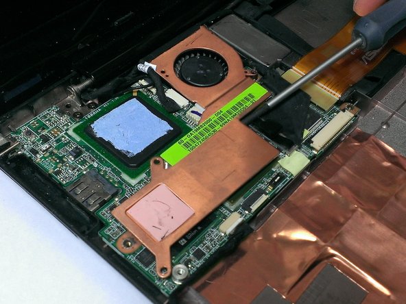

    • Use the Phillips #0 screwdriver to remove the two 2mm screws from the copper heat sink. These are found on the left side of the device.
    • Make sure to remove the adhesive tape from the top of the heat sink.

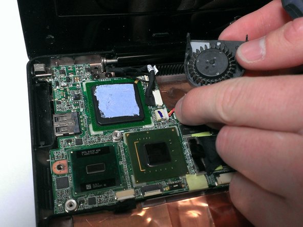

    • Remove the small white connector attached to the fan. Make sure to carefully pull from the white connector. Do not pull the connecting wires, as this can cause damage to the component.
    • Replace with new cooling fan!
