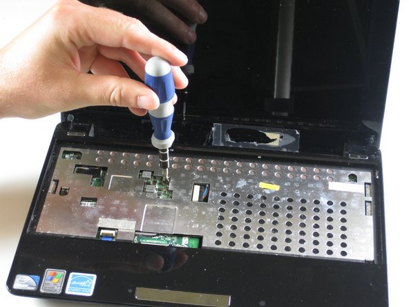

    • Turn computer right side up, and open it.
    • Remove 6 (5.5 mm) screws from inside covering.
    • Disconnect the touch pad ribbon cable.

    • Remove the hard drive ribbon by lifting the black clips upward.
    • Remove (4.6 mm) screws that hold the hard drive in place.
    • There may be only one of these screws, the one at bottom right. The upper position screw may already have been removed (The 4th red circle from the left in step 4).
