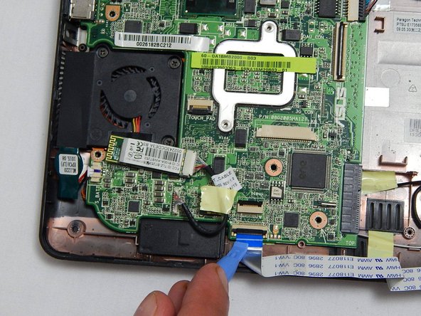

    • Detach the ribbon cable that connects the SD card module and the motherboard by lifting the black clips using the plastic opening tool.

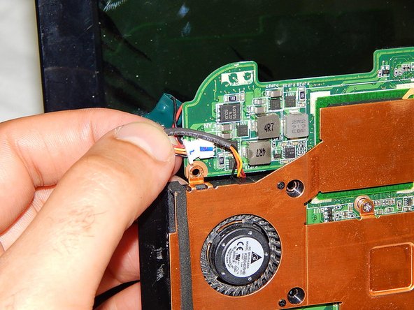

    • Detach the Bluetooth wire located below the fan by gently pulling it upward.

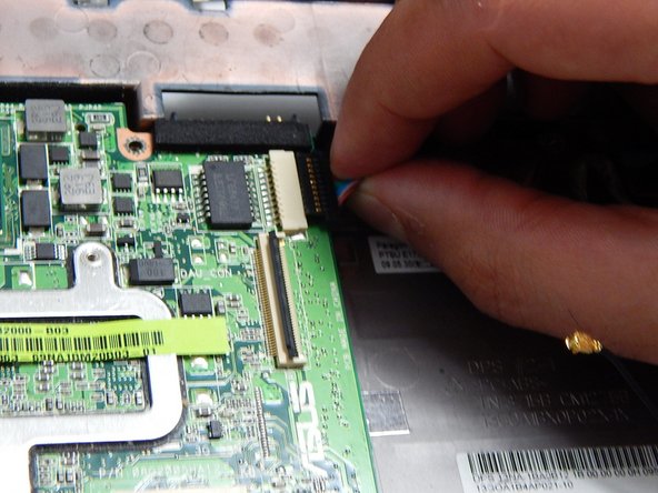

    • Detach the black structure connected to the input cables in the top right center of the motherboard by pulling them to the right, away from the fan.

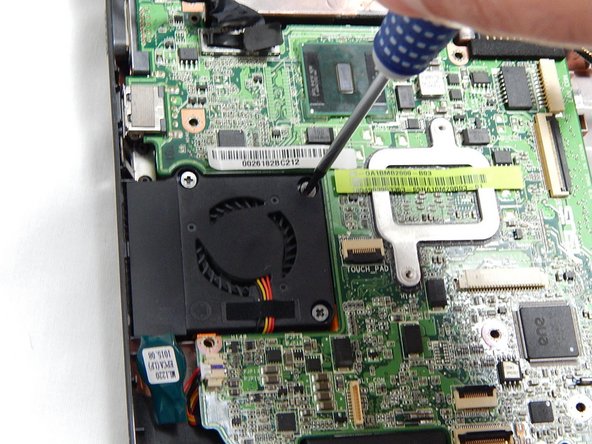

    • Remove the three 5.5 mm screws holding the motherboard to the motherboard plastic frame.
    • Remove the four 5.5 mm screws surrounding the fan.

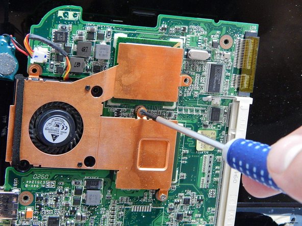

    • Remove two 5.5 mm screws holding the fan and the brass frame to the motherboard.
