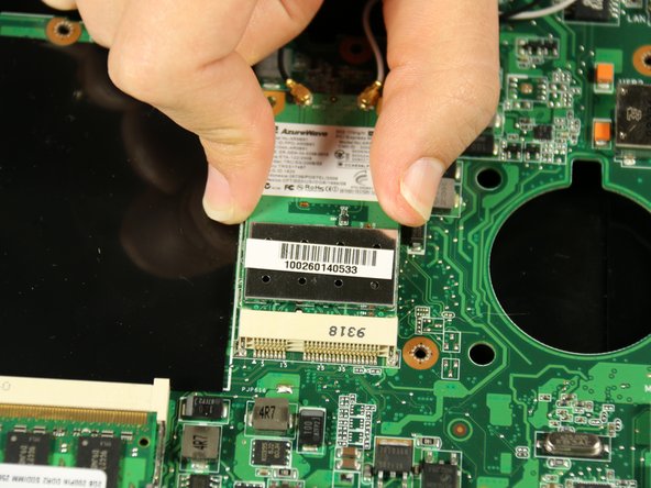

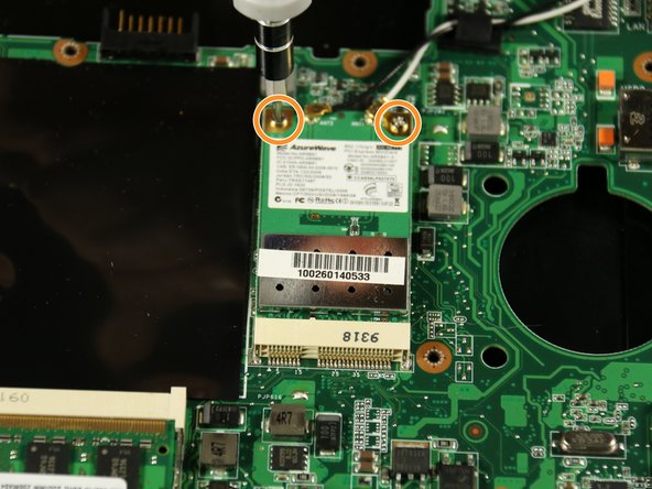

    1. Asus Eee PC 1000HE Wireless Network Card Replacement, Wireless Network Card: crwdns2935265:022crwdnd2935265:01crwdnd2935265:03crwdne2935265:0 Asus Eee PC 1000HE Wireless Network Card Replacement, Wireless Network Card: crwdns2935265:022crwdnd2935265:02crwdnd2935265:03crwdne2935265:0 Asus Eee PC 1000HE Wireless Network Card Replacement, Wireless Network Card: crwdns2935265:022crwdnd2935265:03crwdnd2935265:03crwdne2935265:0
      • Identify the wireless network card.
      • Use a PH00 philips head screwdriver (+) to remove two 4mm screws.
      • Use your hand to carefully lift up and remove the wireless network card from its connection to the motherboard.

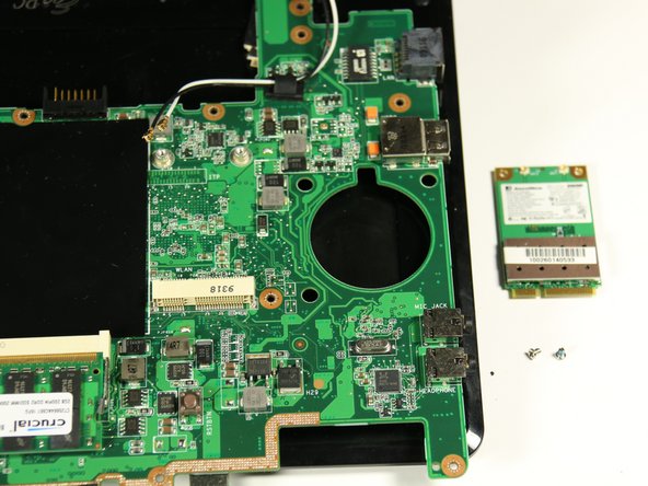

    2. Asus Eee PC 1000HE Wireless Network Card Replacement: crwdns2935265:023crwdnd2935265:01crwdnd2935265:03crwdne2935265:0 Asus Eee PC 1000HE Wireless Network Card Replacement: crwdns2935265:023crwdnd2935265:02crwdnd2935265:03crwdne2935265:0 Asus Eee PC 1000HE Wireless Network Card Replacement: crwdns2935265:023crwdnd2935265:03crwdnd2935265:03crwdne2935265:0
      • Identify the two connections between the screen and the wireless network card. One is attached to a black wire and the other to a white wire.
      • Lift the connections away from the wireless network card.
      • The wireless network card is now completely detached from the netbook.
      • Note the motherboard is also completely detached from the netbook in this step.
