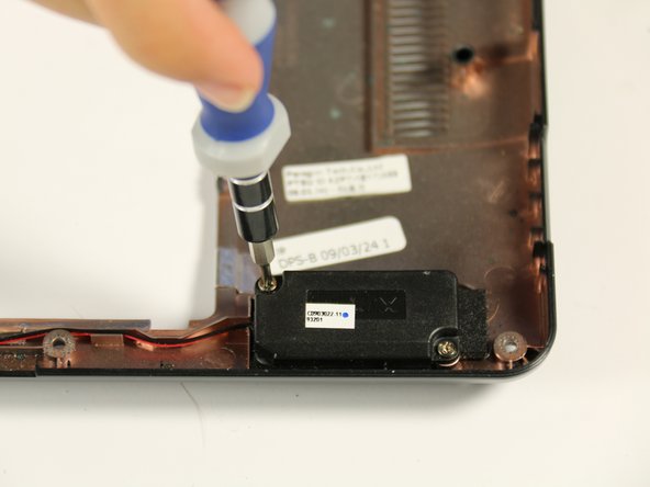

  23. Asus Eee PC 1000HE Speaker Replacement: crwdns2935265:023crwdnd2935265:01crwdnd2935265:03crwdne2935265:0 Asus Eee PC 1000HE Speaker Replacement: crwdns2935265:023crwdnd2935265:02crwdnd2935265:03crwdne2935265:0 Asus Eee PC 1000HE Speaker Replacement: crwdns2935265:023crwdnd2935265:03crwdnd2935265:03crwdne2935265:0
    • Two 4 mm screws hold down each speaker (4 total screws).
    • Remove the two 4mm screws from each speaker using a PH00 phillips head (+). The screws are marked by red circles.

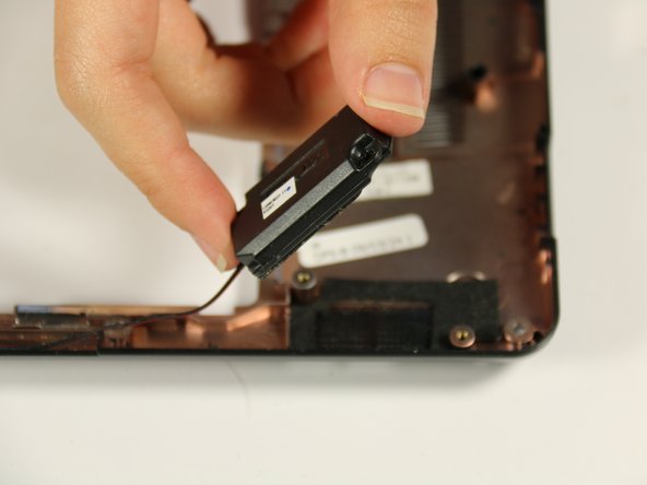

    • Lift the speakers out from the PC
    • The speakers are connected by wires.
  24. Asus Eee PC 1000HE Speaker Replacement: crwdns2935265:024crwdnd2935265:01crwdnd2935265:01crwdne2935265:0
    • Your PC should look like this after removing both speakers
Mike Glenn
