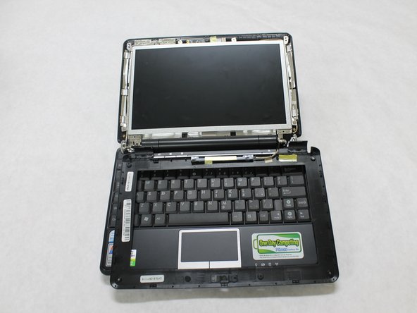

  3. Asus Eee PC 1000HA Screen Replacement: crwdns2935265:03crwdnd2935265:01crwdnd2935265:02crwdne2935265:0 Asus Eee PC 1000HA Screen Replacement: crwdns2935265:03crwdnd2935265:02crwdnd2935265:02crwdne2935265:0
    • Use the metal spudger to pry off the outside frame of the screen.
  4. Asus Eee PC 1000HA Screen Replacement: crwdns2935265:04crwdnd2935265:01crwdnd2935265:01crwdne2935265:0
    • Use the #00 Phillips Head screw driver to remove the 5.44mm screws.
    • There are 6 screws total.
  5. Asus Eee PC 1000HA Screen Replacement: crwdns2935265:05crwdnd2935265:01crwdnd2935265:03crwdne2935265:0 Asus Eee PC 1000HA Screen Replacement: crwdns2935265:05crwdnd2935265:02crwdnd2935265:03crwdne2935265:0 Asus Eee PC 1000HA Screen Replacement: crwdns2935265:05crwdnd2935265:03crwdnd2935265:03crwdne2935265:0
    • Use the metal spudger to gently remove the screen from the laptop.
  6. Asus Eee PC 1000HA Screen Replacement: crwdns2935265:06crwdnd2935265:01crwdnd2935265:03crwdne2935265:0 Asus Eee PC 1000HA Screen Replacement: crwdns2935265:06crwdnd2935265:02crwdnd2935265:03crwdne2935265:0 Asus Eee PC 1000HA Screen Replacement: crwdns2935265:06crwdnd2935265:03crwdnd2935265:03crwdne2935265:0
    • Gently pull the tab that is connecting the laptop to the screen, to fully disconnect the screen from the laptop.
