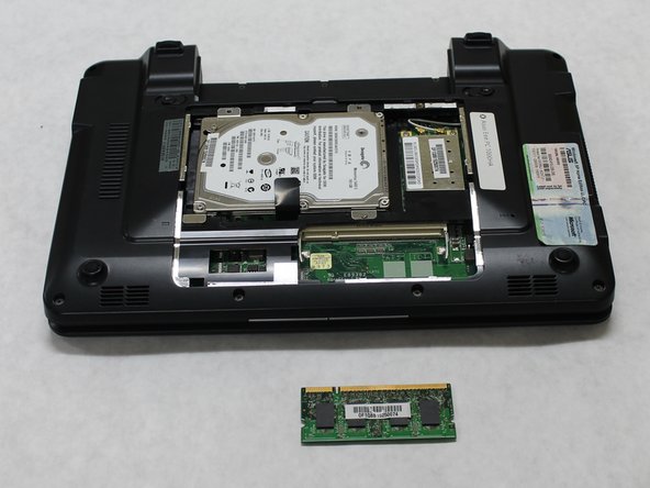

  4. Asus Eee PC 1000HA RAM Replacement: crwdns2935265:04crwdnd2935265:01crwdnd2935265:01crwdne2935265:0
    • Remove the back panel.
    • The RAM is shown by the orange marker.

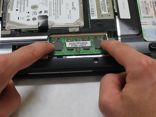

  5. Asus Eee PC 1000HA RAM Replacement: crwdns2935265:05crwdnd2935265:01crwdnd2935265:03crwdne2935265:0 Asus Eee PC 1000HA RAM Replacement: crwdns2935265:05crwdnd2935265:02crwdnd2935265:03crwdne2935265:0 Asus Eee PC 1000HA RAM Replacement: crwdns2935265:05crwdnd2935265:03crwdnd2935265:03crwdne2935265:0
    • Push the two silver tabs outwards and the RAM will pop up to be removed.

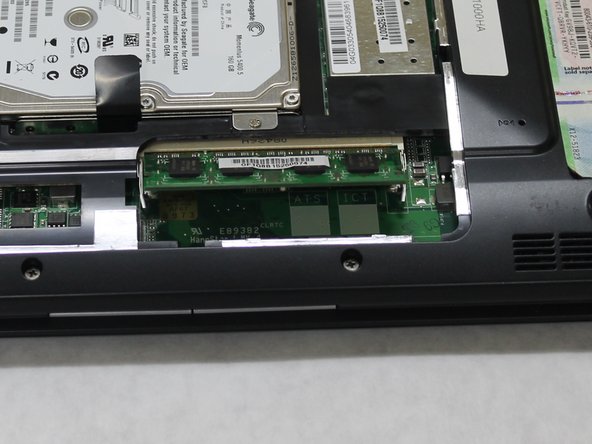

  6. Asus Eee PC 1000HA RAM Replacement: crwdns2935265:06crwdnd2935265:01crwdnd2935265:02crwdne2935265:0 Asus Eee PC 1000HA RAM Replacement: crwdns2935265:06crwdnd2935265:02crwdnd2935265:02crwdne2935265:0
    • Gently pull the RAM outwards to remove.
