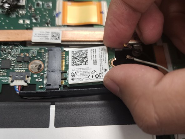

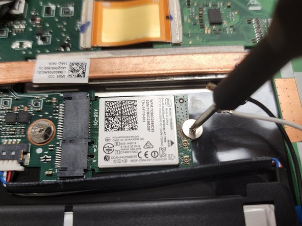

  8. Asus Chromebook Flip C302CA Wi-Fi Card Replacement, Wi-Fi Card: crwdns2935265:08crwdnd2935265:01crwdnd2935265:03crwdne2935265:0 Asus Chromebook Flip C302CA Wi-Fi Card Replacement, Wi-Fi Card: crwdns2935265:08crwdnd2935265:02crwdnd2935265:03crwdne2935265:0 Asus Chromebook Flip C302CA Wi-Fi Card Replacement, Wi-Fi Card: crwdns2935265:08crwdnd2935265:03crwdnd2935265:03crwdne2935265:0
    • Carefully remove the black and white cables connected to the Wi-Fi card.
    • Remove the single 2 mm screw while holding the Wi-Fi card using the Phillips #00 screwdriver.
    • Remove the Wi-Fi card from the laptop.
