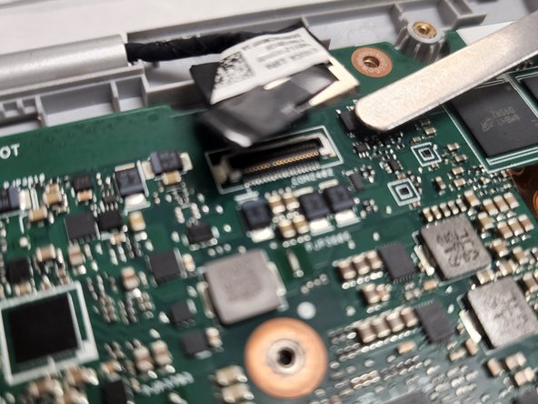

  5. Asus Chromebook Flip C302CA Motherboard Replacement, Battery: crwdns2935265:05crwdnd2935265:01crwdnd2935265:03crwdne2935265:0 Asus Chromebook Flip C302CA Motherboard Replacement, Battery: crwdns2935265:05crwdnd2935265:02crwdnd2935265:03crwdne2935265:0 Asus Chromebook Flip C302CA Motherboard Replacement, Battery: crwdns2935265:05crwdnd2935265:03crwdnd2935265:03crwdne2935265:0
    • Remove the sticker holding the cable using a pair of tweezers.
    • Detach the cable from the motherboard by lifting it up with a spudger.
    • Always use a plastic or nylon ESD-safe tool. Metal spudger and other sharp tools can puncture a battery, potentially causing a fire.

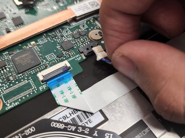

  11. Asus Chromebook Flip C302CA Motherboard Replacement: crwdns2935265:011crwdnd2935265:01crwdnd2935265:02crwdne2935265:0 Asus Chromebook Flip C302CA Motherboard Replacement: crwdns2935265:011crwdnd2935265:02crwdnd2935265:02crwdne2935265:0
    • Remove the speaker cable connected to the motherboard with tweezers.
    • Careful not to damage your cable.

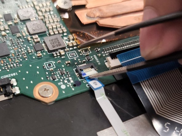

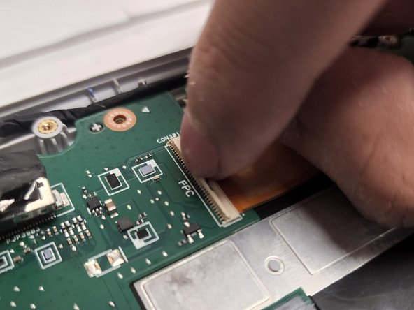

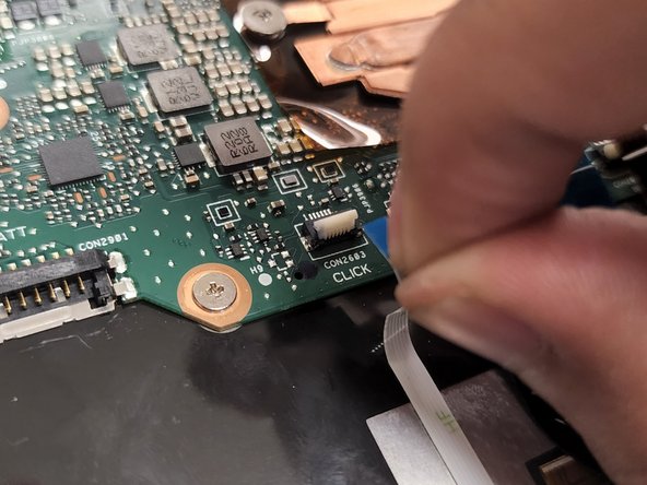

    • Remove the ribbon cable from the motherboard.
    • Then, remove the two 1mm screws with a PH00 screwdriver.

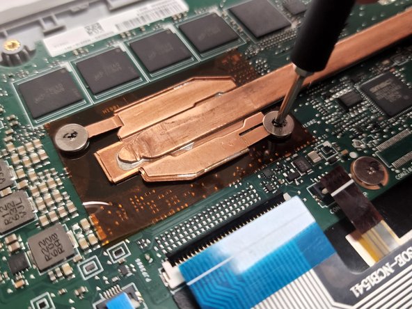

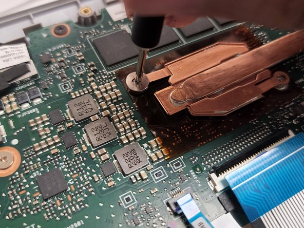

    • Remove the four 2mm screws with a PH00 screwdriver.

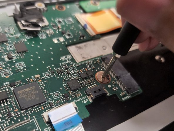

    • Remove the six 1mm Screws with a PH00 screwdriver.

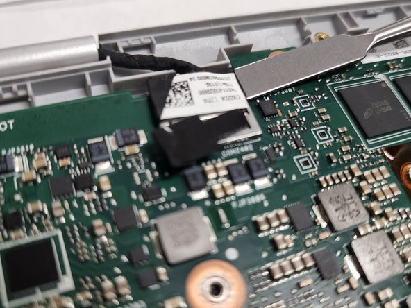

  16. Asus Chromebook Flip C302CA Motherboard Replacement: crwdns2935265:016crwdnd2935265:01crwdnd2935265:03crwdne2935265:0 Asus Chromebook Flip C302CA Motherboard Replacement: crwdns2935265:016crwdnd2935265:02crwdnd2935265:03crwdne2935265:0 Asus Chromebook Flip C302CA Motherboard Replacement: crwdns2935265:016crwdnd2935265:03crwdnd2935265:03crwdne2935265:0

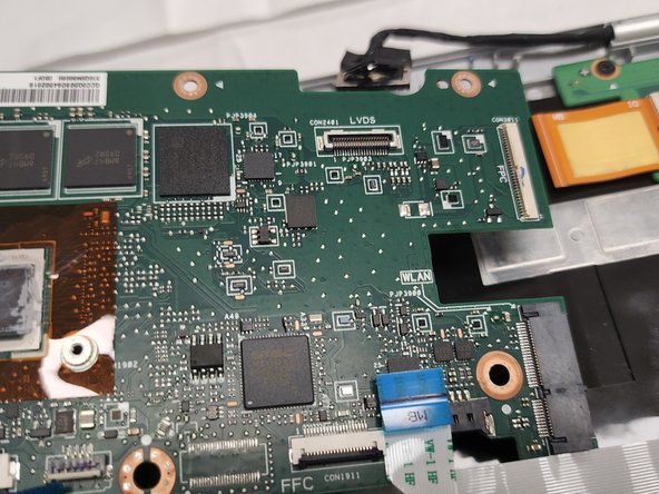

    • Remove the two pictured tabs with a nylon spudger.

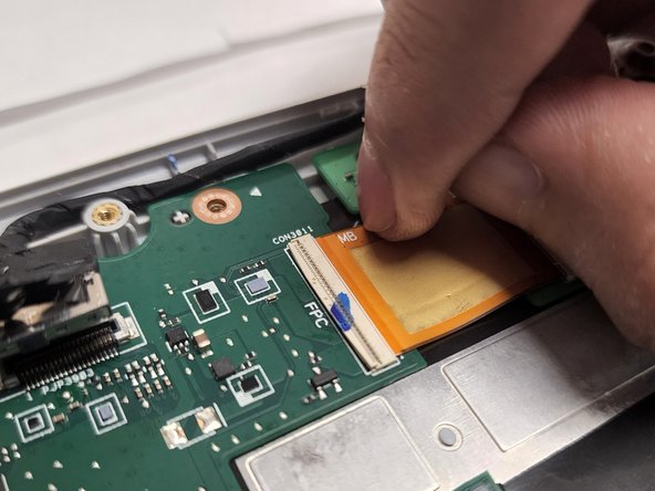

  17. Asus Chromebook Flip C302CA Motherboard Replacement: crwdns2935265:017crwdnd2935265:01crwdnd2935265:03crwdne2935265:0 Asus Chromebook Flip C302CA Motherboard Replacement: crwdns2935265:017crwdnd2935265:02crwdnd2935265:03crwdne2935265:0 Asus Chromebook Flip C302CA Motherboard Replacement: crwdns2935265:017crwdnd2935265:03crwdnd2935265:03crwdne2935265:0

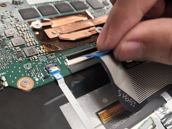

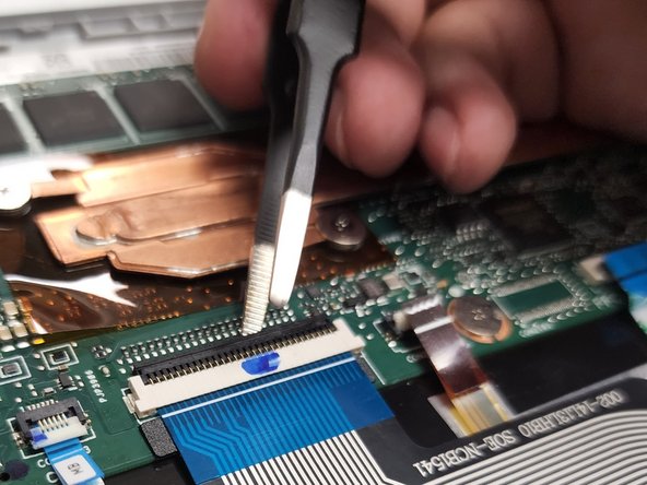

    • Lift the tab with a small pick that connects to the ribbon cable
  18. Asus Chromebook Flip C302CA Motherboard Replacement: crwdns2935265:018crwdnd2935265:01crwdnd2935265:02crwdne2935265:0 Asus Chromebook Flip C302CA Motherboard Replacement: crwdns2935265:018crwdnd2935265:02crwdnd2935265:02crwdne2935265:0
    • Remove the mother from the left side of the computer

Thanks for this very useful guide. We were able to replace the motherboard and put it back together, but the device only runs while plugged in. We double checked all of the connections. How can I check to see if the battery itself is dead? Or maybe there are other ideas to try? Much appreciated.
