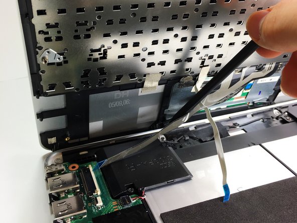

    • Pry the palm rest assembly apart from the bottom cover using a spudger. This step may require extra power. Once the palm rest has been separated from the bottom cover, pull it away from the screen, rather than away from yourself.

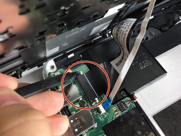

    • Disconnect the touchpad cable and the keyboard cable on the palm rest assembly from the motherboard using the pointed end of a plastic spudger.

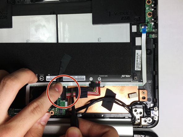

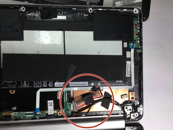

    • Disconnect the DC jack cable and the battery cable from the motherboard using tweezers, the pointed end of a plastic spudger, or by simply pulling the cables apart from the motherboard with your fingers.
  7. Asus Chromebook Flip C100P Speaker Replacement: crwdns2935265:07crwdnd2935265:01crwdnd2935265:02crwdne2935265:0 Asus Chromebook Flip C100P Speaker Replacement: crwdns2935265:07crwdnd2935265:02crwdnd2935265:02crwdne2935265:0

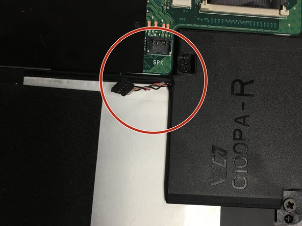

    • Disconnect the speaker cable from the motherboard using tweezers or the pointed end of a plastic spudger.

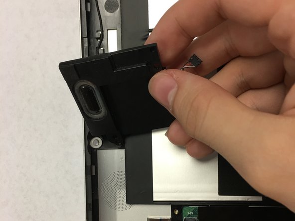

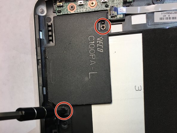

    • Remove the four 4.2mm speaker screws, then remove the two speakers using a Phillips #0 screwdriver.
To reassemble your device, replace the broken or faulty speaker system with a new speaker system and follow these instructions in reverse order.
