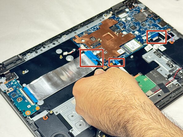

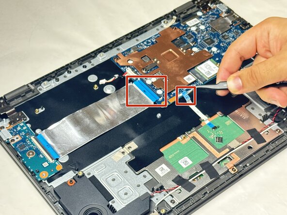

  4. Asus Chromebook CM1402CM2A-DS44 Motherboard Replacement, Motherboard: crwdns2935265:04crwdnd2935265:01crwdnd2935265:03crwdne2935265:0 Asus Chromebook CM1402CM2A-DS44 Motherboard Replacement, Motherboard: crwdns2935265:04crwdnd2935265:02crwdnd2935265:03crwdne2935265:0 Asus Chromebook CM1402CM2A-DS44 Motherboard Replacement, Motherboard: crwdns2935265:04crwdnd2935265:03crwdnd2935265:03crwdne2935265:0
    • Disconnect the three ribbon cables connecting the motherboard to the other components of the Chromebook using a pair of tweezers.

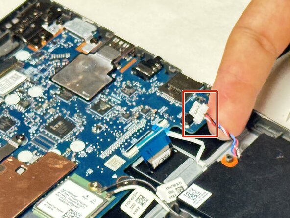

  5. Asus Chromebook CM1402CM2A-DS44 Motherboard Replacement: crwdns2935265:05crwdnd2935265:01crwdnd2935265:03crwdne2935265:0 Asus Chromebook CM1402CM2A-DS44 Motherboard Replacement: crwdns2935265:05crwdnd2935265:02crwdnd2935265:03crwdne2935265:0 Asus Chromebook CM1402CM2A-DS44 Motherboard Replacement: crwdns2935265:05crwdnd2935265:03crwdnd2935265:03crwdne2935265:0
    • Unplug any external components such as the speaker and other cables.

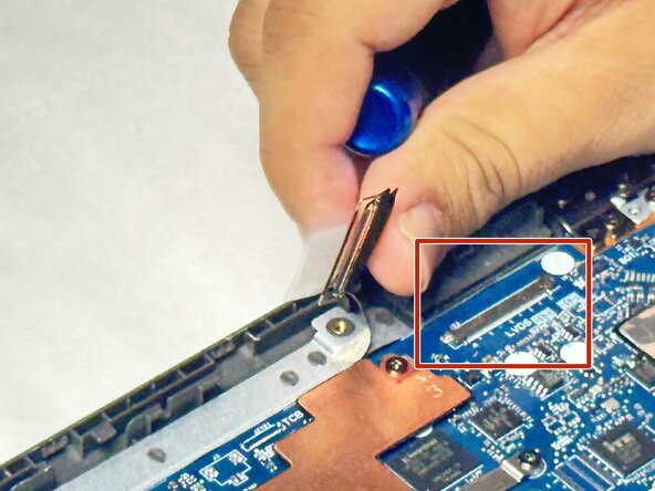

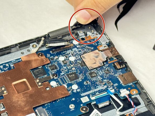

  6. Asus Chromebook CM1402CM2A-DS44 Motherboard Replacement: crwdns2935265:06crwdnd2935265:01crwdnd2935265:02crwdne2935265:0 Asus Chromebook CM1402CM2A-DS44 Motherboard Replacement: crwdns2935265:06crwdnd2935265:02crwdnd2935265:02crwdne2935265:0
    • Remove the screws from the display hinges using a Phillips #1 screwdriver.
    • Lift the hinges up.

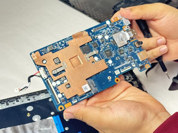

    • Remove the five screws from the motherboard using a Phillips #1 screwdriver.
    • Remove the motherboard from the laptop.
