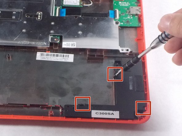

  9. Asus Chromebook C300SA-DS02 VECO Speakers  Replacement: crwdns2935265:09crwdnd2935265:01crwdnd2935265:02crwdne2935265:0 Asus Chromebook C300SA-DS02 VECO Speakers  Replacement: crwdns2935265:09crwdnd2935265:02crwdnd2935265:02crwdne2935265:0
    • Start by removing the right speaker first.
    • There are two metal clips and one plastic clip holding the right speaker in place. Push them back and lift speaker out of the laptop.
    • Use a screwdriver to gently push back the metal clips.
  10. Asus Chromebook C300SA-DS02 VECO Speakers  Replacement: crwdns2935265:010crwdnd2935265:01crwdnd2935265:02crwdne2935265:0 Asus Chromebook C300SA-DS02 VECO Speakers  Replacement: crwdns2935265:010crwdnd2935265:02crwdnd2935265:02crwdne2935265:0

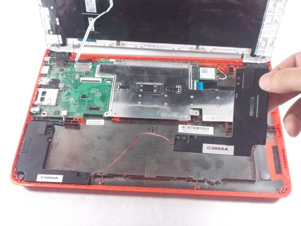

    • Untangle the wire connecting the right speaker to the left speaker.
    • Move right speaker and wires away from your working space.
    • Do not lift wire straight up, there are five interlocking ribs holding this wire in place.
  11. Asus Chromebook C300SA-DS02 VECO Speakers  Replacement: crwdns2935265:011crwdnd2935265:01crwdnd2935265:01crwdne2935265:0
    • You can use a screwdriver to push back the clips if needed.
  12. Asus Chromebook C300SA-DS02 VECO Speakers  Replacement: crwdns2935265:012crwdnd2935265:01crwdnd2935265:01crwdne2935265:0
    • Lift speakers and cable away from the laptop.
