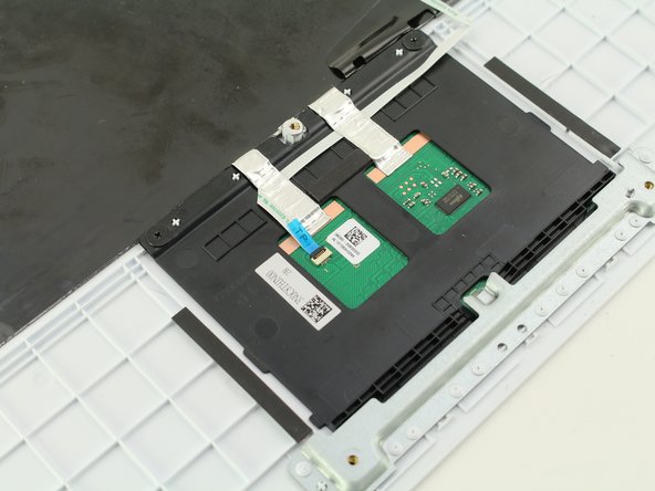

  6. Asus Chromebook C300SA-DS02 Trackpad Replacement: crwdns2935265:06crwdnd2935265:01crwdnd2935265:02crwdne2935265:0 Asus Chromebook C300SA-DS02 Trackpad Replacement: crwdns2935265:06crwdnd2935265:02crwdnd2935265:02crwdne2935265:0
    • Peel up the two pieces of foil tape holding down the trackpad.
  7. Asus Chromebook C300SA-DS02 Trackpad Replacement: crwdns2935265:07crwdnd2935265:01crwdnd2935265:03crwdne2935265:0 Asus Chromebook C300SA-DS02 Trackpad Replacement: crwdns2935265:07crwdnd2935265:02crwdnd2935265:03crwdne2935265:0 Asus Chromebook C300SA-DS02 Trackpad Replacement: crwdns2935265:07crwdnd2935265:03crwdnd2935265:03crwdne2935265:0

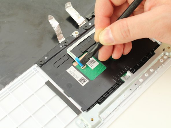

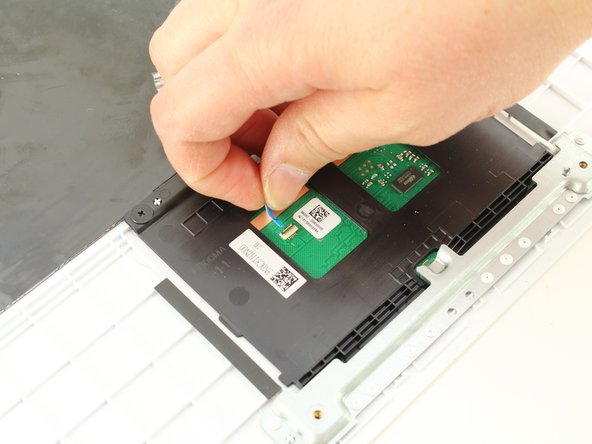

    • Use a spudger to release the locking bar of the ZIF connector near the center of the trackpad.
    • Slide the cable ribbon from the connector.
  8. Asus Chromebook C300SA-DS02 Trackpad Replacement: crwdns2935265:08crwdnd2935265:01crwdnd2935265:01crwdne2935265:0
    • Peel back the ribbon cable, which is adhered to the trackpad.
