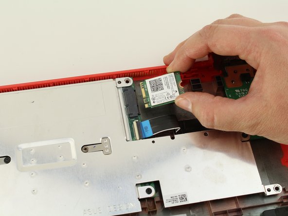

    • Use the spudger to pop the black and white coaxial WiFi cables up from the WiFi card.
  13. Asus Chromebook C300SA-DS02 Motherboard Replacement: crwdns2935265:013crwdnd2935265:01crwdnd2935265:02crwdne2935265:0 Asus Chromebook C300SA-DS02 Motherboard Replacement: crwdns2935265:013crwdnd2935265:02crwdnd2935265:02crwdne2935265:0
    • Remove the one 3.6mm Phillips #0 screw from the WiFi card.
    • Pull and lift the WiFi card away from the motherboard.

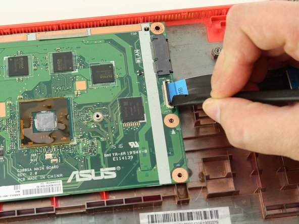

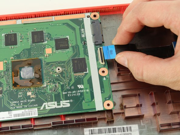

    • Using the black nylon spudger, unlock the black bar on the ZIF connector attached to the mid-right of the motherboard.
    • Remove the ribbon cable that attaches the motherboard to the daughterboard.

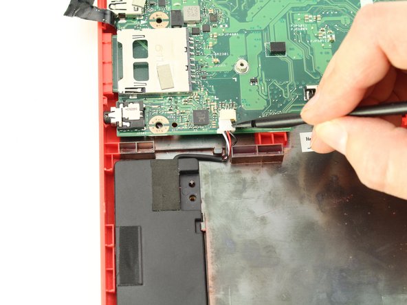

    • Using the black nylon spudger, carefully slide the speaker cable connector out from its attachment on the motherboard.

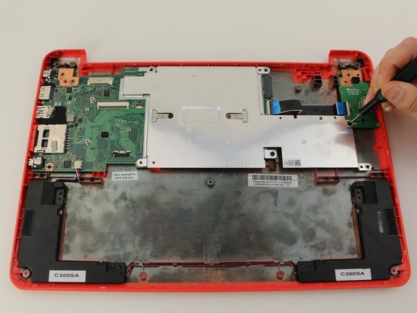

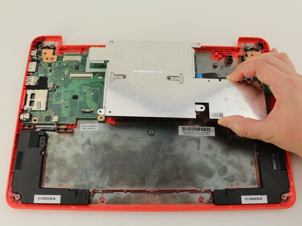

  18. Asus Chromebook C300SA-DS02 Motherboard Replacement: crwdns2935265:018crwdnd2935265:01crwdnd2935265:01crwdne2935265:0
    • Wiggle and pull the motherboard out from the bottom case.
