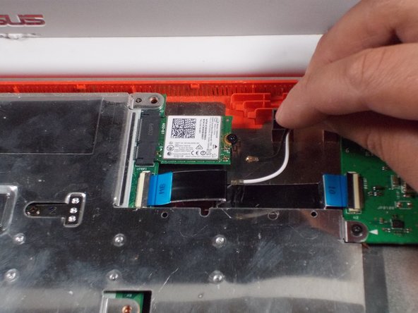

  8. Asus Chromebook C300SA-DS02 LED Screen Replacement, LED Screen: crwdns2935265:08crwdnd2935265:01crwdnd2935265:02crwdne2935265:0 Asus Chromebook C300SA-DS02 LED Screen Replacement, LED Screen: crwdns2935265:08crwdnd2935265:02crwdnd2935265:02crwdne2935265:0
    • Unplug the black and white cable from the motherboard.
    • These two wires connect to the antenna within the display assembly. The white cable is longer and connects to the bottom import.

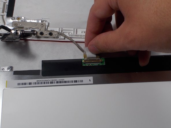

  14. Asus Chromebook C300SA-DS02 LED Screen Replacement: crwdns2935265:014crwdnd2935265:01crwdnd2935265:02crwdne2935265:0 Asus Chromebook C300SA-DS02 LED Screen Replacement: crwdns2935265:014crwdnd2935265:02crwdnd2935265:02crwdne2935265:0
    • Gently lift screen
    • Peel back the adhesive covering the cable.
    • Remove the cable to free the screen.
