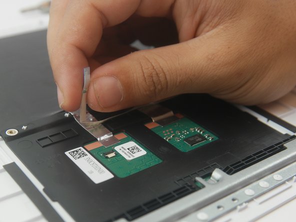

  4. Asus Chromebook C300MA-DH02 Trackpad Replacement, Trackpad: crwdns2935265:04crwdnd2935265:01crwdnd2935265:02crwdne2935265:0 Asus Chromebook C300MA-DH02 Trackpad Replacement, Trackpad: crwdns2935265:04crwdnd2935265:02crwdnd2935265:02crwdne2935265:0
    • Unplug the blue wire that connects trackpad to the keyboard.
  5. Asus Chromebook C300MA-DH02 Trackpad Replacement: crwdns2935265:05crwdnd2935265:01crwdnd2935265:01crwdne2935265:0
    • Remove the aluminum tape that secures the trackpad. Use tweezers if necessary.

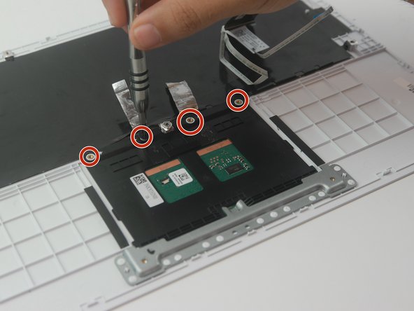

  6. Asus Chromebook C300MA-DH02 Trackpad Replacement: crwdns2935265:06crwdnd2935265:01crwdnd2935265:02crwdne2935265:0 Asus Chromebook C300MA-DH02 Trackpad Replacement: crwdns2935265:06crwdnd2935265:02crwdnd2935265:02crwdne2935265:0
    • Using the Phillips #000 screwdriver, remove the (4) four "4 mm" screws that secure trackpad onto keyboard.

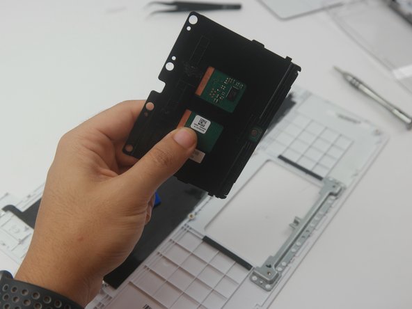

  7. Asus Chromebook C300MA-DH02 Trackpad Replacement: crwdns2935265:07crwdnd2935265:01crwdnd2935265:02crwdne2935265:0 Asus Chromebook C300MA-DH02 Trackpad Replacement: crwdns2935265:07crwdnd2935265:02crwdnd2935265:02crwdne2935265:0
    • Using a plastic opening tool, pry out the touchpad from the metal securing bracket.
