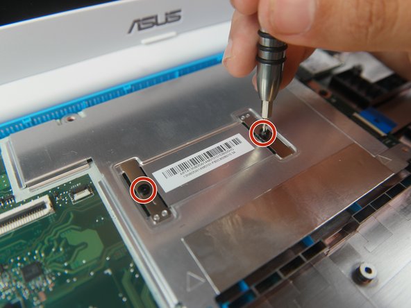

  4. Asus Chromebook C300MA-DH02 Motherboard Replacement, Motherboard: crwdns2935265:04crwdnd2935265:01crwdnd2935265:02crwdne2935265:0 Asus Chromebook C300MA-DH02 Motherboard Replacement, Motherboard: crwdns2935265:04crwdnd2935265:02crwdnd2935265:02crwdne2935265:0
    • Remove the 4 "4mm" screws on the silver motherboard cover with the Phillips #000 Screwdriver.
    • Remove the motherboard silver mount.

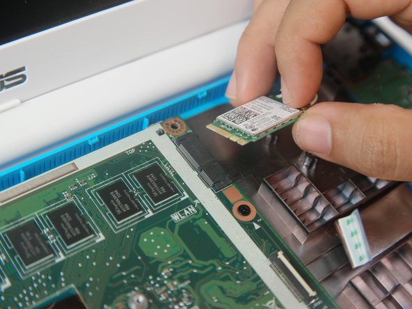

    • Use the Phillips #000 Screwdriver to remove the screw on right side of wireless card.
    • Remove the wireless card.

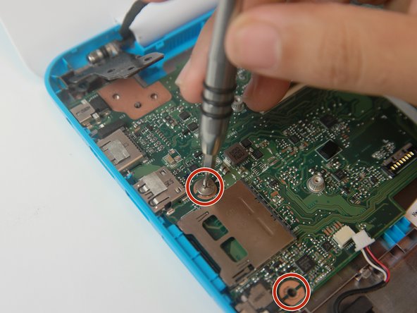

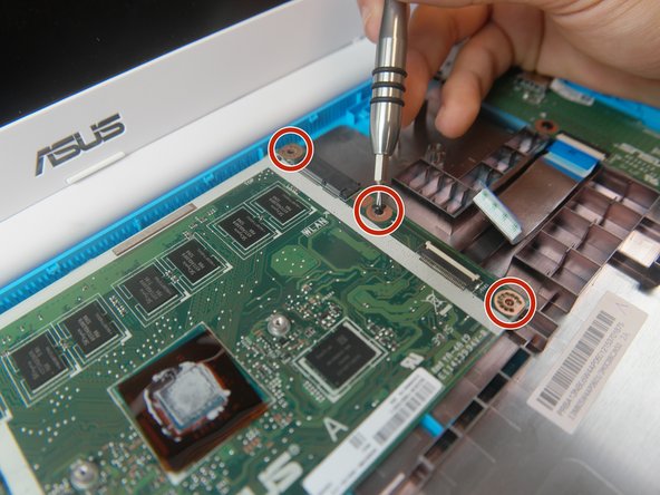

    • Remove (3) three "4mm" screws that connect the hinge to the motherboard using the Phillips #000 Screwdriver.
    • Remove (5) five "4mm" screws around two sides of motherboard using the Phillips #000 Screwdriver.
