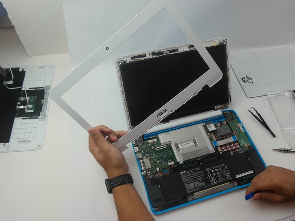

    • Flip the Chromebook over so that the underside is facing up.
    • Using the Phillips PH #000 screwdriver, remove the 11 "4mm" screws on the back of the device.
  2. Asus Chromebook C300MA-DH02 Display Replacement: crwdns2935265:02crwdnd2935265:01crwdnd2935265:01crwdne2935265:0
    • Wedge the plastic opening tool between the bottom cover of the laptop and the keyboard panel.
    • Apply pressure and move the plastic opening tool around the border of the laptop until it pops out.
  3. Asus Chromebook C300MA-DH02 Display Replacement: crwdns2935265:03crwdnd2935265:01crwdnd2935265:02crwdne2935265:0 Asus Chromebook C300MA-DH02 Display Replacement: crwdns2935265:03crwdnd2935265:02crwdnd2935265:02crwdne2935265:0
    • Once the keyboard panel pops out, slowly move it upwards so that the keyboard connection is visible.
    • Remove the keyboard connection from the motherboard by pulling it outwards from the connector.

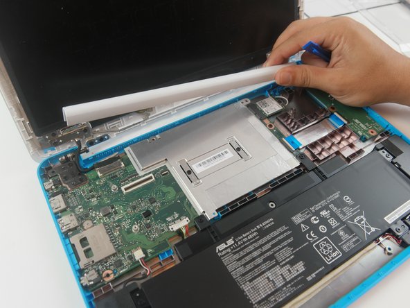

  4. Asus Chromebook C300MA-DH02 Display Replacement, Display: crwdns2935265:04crwdnd2935265:01crwdnd2935265:02crwdne2935265:0 Asus Chromebook C300MA-DH02 Display Replacement, Display: crwdns2935265:04crwdnd2935265:02crwdnd2935265:02crwdne2935265:0
    • Remove the hinge protector by using the plastic opening tool to gently lift it up. It should come up easily.
  5. Asus Chromebook C300MA-DH02 Display Replacement: crwdns2935265:05crwdnd2935265:01crwdnd2935265:02crwdne2935265:0 Asus Chromebook C300MA-DH02 Display Replacement: crwdns2935265:05crwdnd2935265:02crwdnd2935265:02crwdne2935265:0
    • Using the plastic opening tool, separate the display cover bracket from the back of the display. Start from the top.

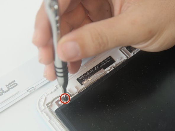

  6. Asus Chromebook C300MA-DH02 Display Replacement: crwdns2935265:06crwdnd2935265:01crwdnd2935265:02crwdne2935265:0 Asus Chromebook C300MA-DH02 Display Replacement: crwdns2935265:06crwdnd2935265:02crwdnd2935265:02crwdne2935265:0
    • Remove the (4) four "4mm" screws in each corner that hold the display using the Phillips #000 screwdriver.

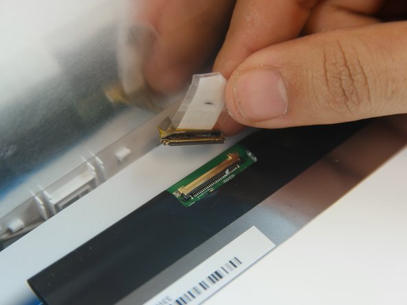

  8. Asus Chromebook C300MA-DH02 Display Replacement: crwdns2935265:08crwdnd2935265:01crwdnd2935265:02crwdne2935265:0 Asus Chromebook C300MA-DH02 Display Replacement: crwdns2935265:08crwdnd2935265:02crwdnd2935265:02crwdne2935265:0
    • Lift the tape covering the connector with the tweezers.
    • Gently remove the display connector from the motherboard.
