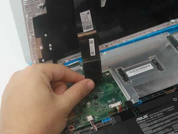

    • Once the keyboard panel pops out, slowly move it upwards so that the keyboard connection is visible.
    • Remove the keyboard connection from the motherboard by pulling it outwards from the connector.

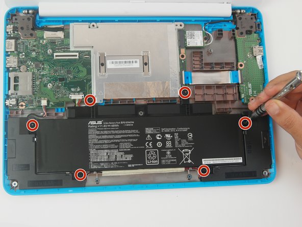

  4. Asus Chromebook C300MA-DH02 Battery Replacement, Battery: crwdns2935265:04crwdnd2935265:01crwdnd2935265:02crwdne2935265:0 Asus Chromebook C300MA-DH02 Battery Replacement, Battery: crwdns2935265:04crwdnd2935265:02crwdnd2935265:02crwdne2935265:0
    • Remove (6) six "4mm" screws that hold the battery using the Phillips #000 screwdriver.
