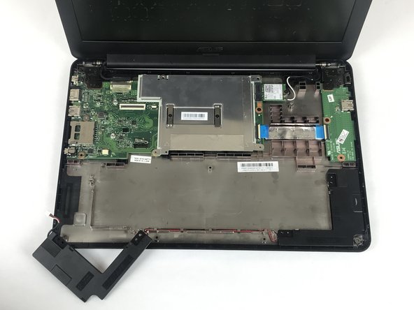

  8. Asus Chromebook C300MA-DB01 Speaker Replacement Speakers Replacement, Speakers: crwdns2935265:08crwdnd2935265:01crwdnd2935265:01crwdne2935265:0
    • Use plastic opening tool to pry off the wire connecting the left side speaker to the circuit board.
  9. Asus Chromebook C300MA-DB01 Speaker Replacement Speakers Replacement: crwdns2935265:09crwdnd2935265:01crwdnd2935265:02crwdne2935265:0 Asus Chromebook C300MA-DB01 Speaker Replacement Speakers Replacement: crwdns2935265:09crwdnd2935265:02crwdnd2935265:02crwdne2935265:0
    • Use plastic opening tool to pry off the left side speaker.
  10. Asus Chromebook C300MA-DB01 Speaker Replacement Speakers Replacement: crwdns2935265:010crwdnd2935265:01crwdnd2935265:01crwdne2935265:0
    • Gently remove the wire connecting the left and right speakers from it's channel. Be careful as to not tear or damage the wire.
  11. Asus Chromebook C300MA-DB01 Speaker Replacement Speakers Replacement: crwdns2935265:011crwdnd2935265:01crwdnd2935265:01crwdne2935265:0
    • Use plastic opening tool to pry off right side speaker.
  12. Asus Chromebook C300MA-DB01 Speaker Replacement Speakers Replacement: crwdns2935265:012crwdnd2935265:01crwdnd2935265:01crwdne2935265:0
    • Lift and remove both speakers and connecting wire.
