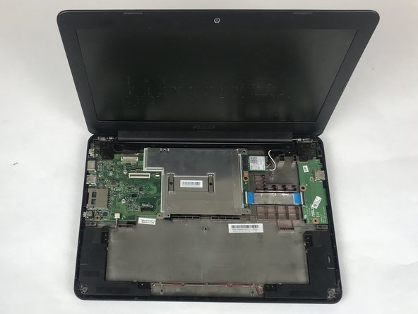

    • Lift the keyboard panel away from the components at its hinges, which are located at the back of the laptop.
  5. Asus Chromebook C300MA-DB01 Mouse Pad Replacement, Mouse pad: crwdns2935265:05crwdnd2935265:01crwdnd2935265:01crwdne2935265:0
    • Use plastic opening tool to pry open clip holding keyboard wires to the circuit board.
    • Use plastic opening tool to pry open clip holding mouse pad wires to circuit board.
  6. Asus Chromebook C300MA-DB01 Mouse Pad Replacement: crwdns2935265:06crwdnd2935265:01crwdnd2935265:02crwdne2935265:0 Asus Chromebook C300MA-DB01 Mouse Pad Replacement: crwdns2935265:06crwdnd2935265:02crwdnd2935265:02crwdne2935265:0
    • Lift and remove keyboard from device. The keyboard and Mouse pad are one part that must be replaced simultaneously.
