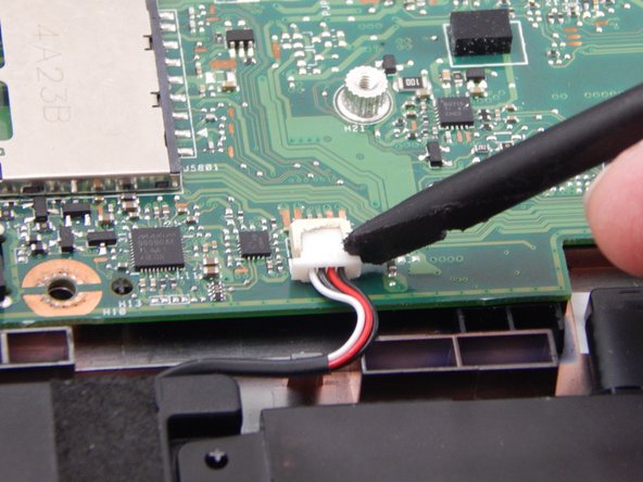

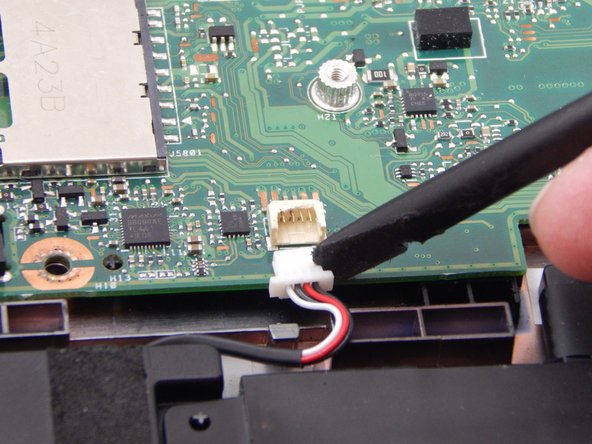

  5. Asus Chromebook C300MA-BBCLN12 Motherboard Replacement: crwdns2935265:05crwdnd2935265:01crwdnd2935265:02crwdne2935265:0 Asus Chromebook C300MA-BBCLN12 Motherboard Replacement: crwdns2935265:05crwdnd2935265:02crwdnd2935265:02crwdne2935265:0

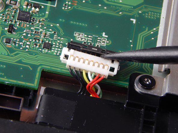

    • Disconnect the bundled cable connector that attaches the battery to the motherboard using the small plastic spudger.

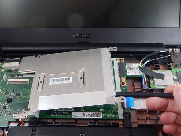

  7. Asus Chromebook C300MA-BBCLN12 Motherboard Replacement, Motherboard: crwdns2935265:07crwdnd2935265:01crwdnd2935265:03crwdne2935265:0 Asus Chromebook C300MA-BBCLN12 Motherboard Replacement, Motherboard: crwdns2935265:07crwdnd2935265:02crwdnd2935265:03crwdne2935265:0 Asus Chromebook C300MA-BBCLN12 Motherboard Replacement, Motherboard: crwdns2935265:07crwdnd2935265:03crwdnd2935265:03crwdne2935265:0
    • Remove the two 6.0mm Phillips #00 screws that secure the metal heat shield to the motherboard.
    • Remove the metal heat shield.

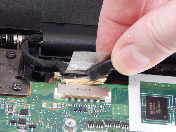

  8. Asus Chromebook C300MA-BBCLN12 Motherboard Replacement: crwdns2935265:08crwdnd2935265:01crwdnd2935265:03crwdne2935265:0 Asus Chromebook C300MA-BBCLN12 Motherboard Replacement: crwdns2935265:08crwdnd2935265:02crwdnd2935265:03crwdne2935265:0 Asus Chromebook C300MA-BBCLN12 Motherboard Replacement: crwdns2935265:08crwdnd2935265:03crwdnd2935265:03crwdne2935265:0

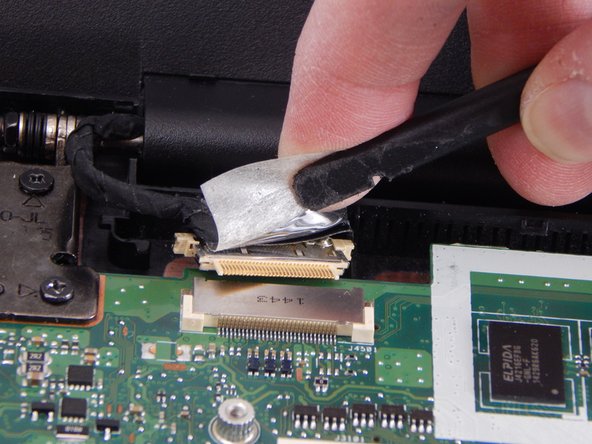

    • Peel back the protective tape that covers the display cable connector.
    • Disconnect the display cable from the motherboard using the plastic spudger tool.

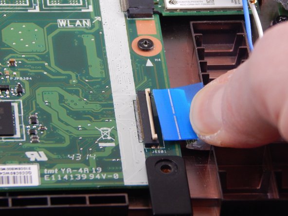

  10. Asus Chromebook C300MA-BBCLN12 Motherboard Replacement: crwdns2935265:010crwdnd2935265:01crwdnd2935265:03crwdne2935265:0 Asus Chromebook C300MA-BBCLN12 Motherboard Replacement: crwdns2935265:010crwdnd2935265:02crwdnd2935265:03crwdne2935265:0 Asus Chromebook C300MA-BBCLN12 Motherboard Replacement: crwdns2935265:010crwdnd2935265:03crwdnd2935265:03crwdne2935265:0

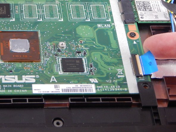

    • Flip back the hinge that secures the blue daughterboard cable to the motherboard using the tweezers.
    • Disconnect the blue cable connecting the motherboard to the daughterboard by pulling on the blue cable tab.

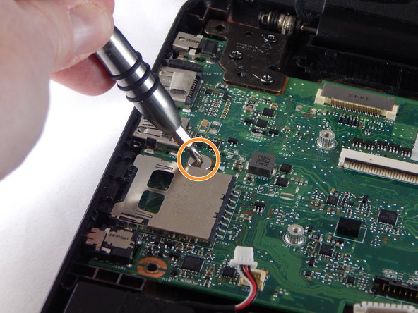

    • Remove the four 3.0mm Phillips #00 screws that attach the left hinge.
    • Remove the large silver 5.0mm Phillips #00 screw from the center-left side of the motherboard.

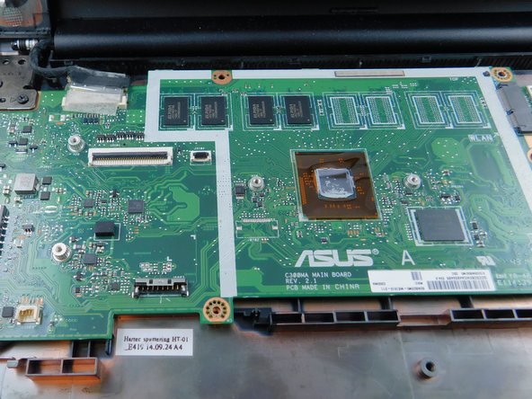

  13. Asus Chromebook C300MA-BBCLN12 Motherboard Replacement: crwdns2935265:013crwdnd2935265:01crwdnd2935265:01crwdne2935265:0
    • Remove the motherboard.
