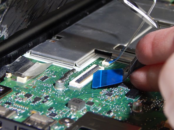

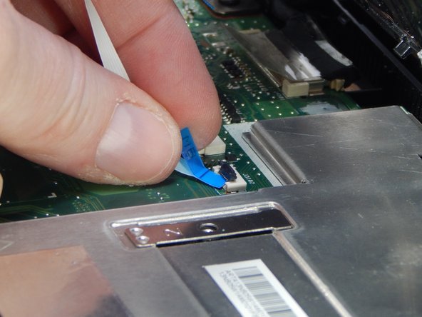

    • Flip back the hinges on the connectors that secure the wide black cable and the narrow white cable using the tweezers.
    • Disconnect the wide black cable from the motherboard by pulling the blue cable tab straight out of the connector.
    • Disconnect the white ribbon cable from the motherboard by pulling the blue cable tab straight out of the connector.

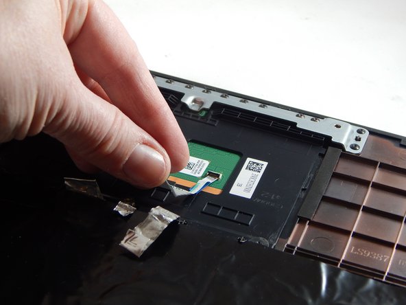

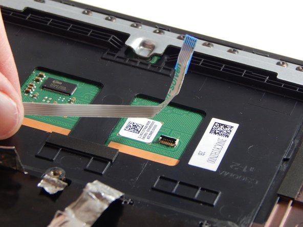

    • Flip back the hinge on the connector that secures the white ribbon cable to the underside of the palm rest assembly using the tweezers.
    • Disconnect the white ribbon cable from the palm rest assembly by pulling the cable straight out of the connector.

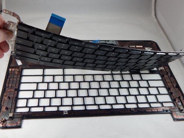

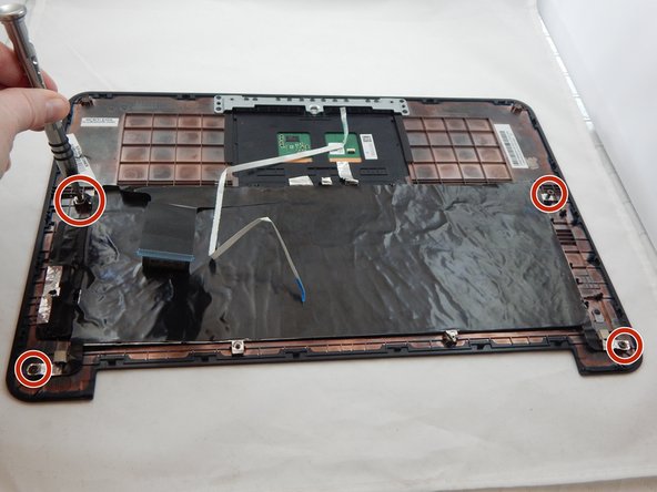

    • Remove the palm rest assembly from the bottom housing and lay it on a flat surface with the keyboard facing downward.
    • Remove the four 5.0mm PH00 Phillips screws securing the keyboard to the palm rest assembly.
    • Separate the keyboard from the palm rest assembly.
