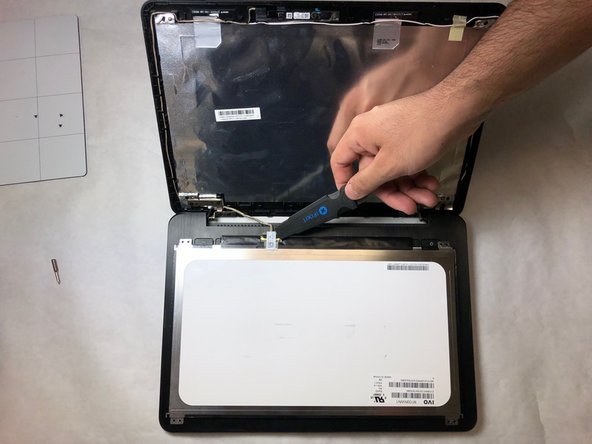

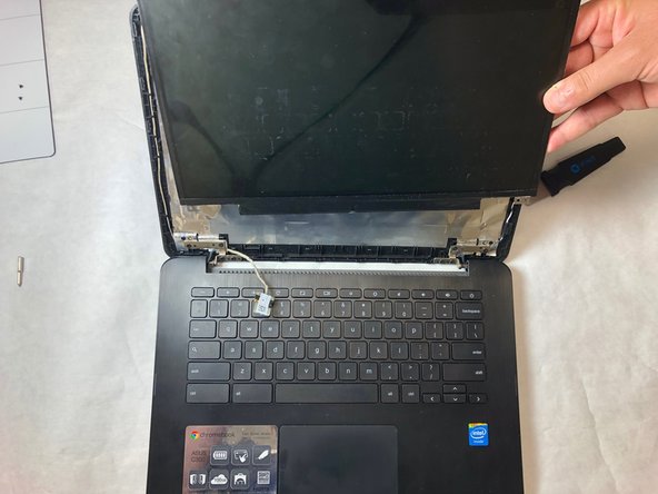

  3. Asus Chromebook C300MA DB01 Screen Replacement: crwdns2935265:03crwdnd2935265:01crwdnd2935265:03crwdne2935265:0 Asus Chromebook C300MA DB01 Screen Replacement: crwdns2935265:03crwdnd2935265:02crwdnd2935265:03crwdne2935265:0 Asus Chromebook C300MA DB01 Screen Replacement: crwdns2935265:03crwdnd2935265:03crwdnd2935265:03crwdne2935265:0
    • Use a Phillips #1 screwdriver to remove the four screws on each corner of the screen.
    • Separate the screen from the top of the Chromebook with the Jimmy.
    • Avoid pulling the screen too far from the device as this can disconnect the wire located at the bottom of the screen.
    • Use the Jimmy to lift the latch on the wire jack.
    • Remove the wires and detach the screen from the device manually.
