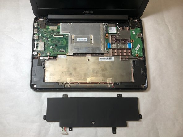

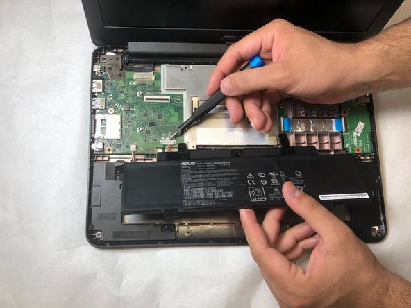

  4. Asus Chromebook C300MA DB01 Battery Replacement, Removing the battery: crwdns2935265:04crwdnd2935265:01crwdnd2935265:03crwdne2935265:0 Asus Chromebook C300MA DB01 Battery Replacement, Removing the battery: crwdns2935265:04crwdnd2935265:02crwdnd2935265:03crwdne2935265:0 Asus Chromebook C300MA DB01 Battery Replacement, Removing the battery: crwdns2935265:04crwdnd2935265:03crwdnd2935265:03crwdne2935265:0
    • Remove the six 6.0mm Phillips screws on the battery.
    • Remove the wire jack from the battery. Use a nylon spudger to lift the latch.
    • Remove the battery from the device.
