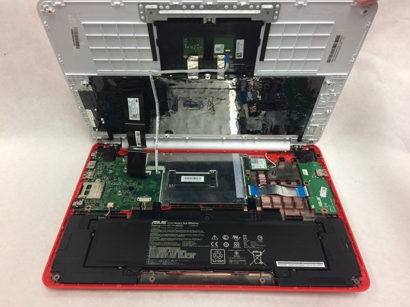

  3. Asus Chromebook C300M USB Port Replacement: crwdns2935265:03crwdnd2935265:01crwdnd2935265:02crwdne2935265:0 Asus Chromebook C300M USB Port Replacement: crwdns2935265:03crwdnd2935265:02crwdnd2935265:02crwdne2935265:0
    • Fully separate the plastic case from the keyboard by lifting it upward.

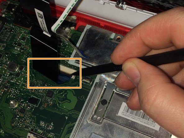

  4. Asus Chromebook C300M USB Port Replacement: crwdns2935265:04crwdnd2935265:01crwdnd2935265:02crwdne2935265:0 Asus Chromebook C300M USB Port Replacement: crwdns2935265:04crwdnd2935265:02crwdnd2935265:02crwdne2935265:0
    • The small and wide ribbon cables connect the keyboard to the motherboard.
    • Disconnect the small ribbon cable by lifting the flap and sliding it out of the motherboard input toward the battery using a spudger.
    • Disconnect the wide ribbon cable by lifting the flap and sliding it out of the motherboard input toward the battery using a spudger.

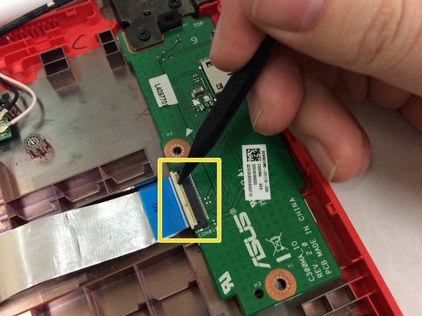

  5. Asus Chromebook C300M USB Port Replacement: crwdns2935265:05crwdnd2935265:01crwdnd2935265:02crwdne2935265:0 Asus Chromebook C300M USB Port Replacement: crwdns2935265:05crwdnd2935265:02crwdnd2935265:02crwdne2935265:0
    • Disconnect the USB port in the top right corner from the motherboard.
    • Unplug the the wide ribbon cable using spudger.

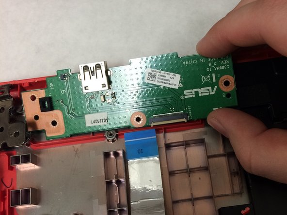

  6. Asus Chromebook C300M USB Port Replacement: crwdns2935265:06crwdnd2935265:01crwdnd2935265:02crwdne2935265:0 Asus Chromebook C300M USB Port Replacement: crwdns2935265:06crwdnd2935265:02crwdnd2935265:02crwdne2935265:0
    • Remove the single 3mm screw on the left and bottom side of the USB Port using the Phillips #1 screwdriver.
    • Remove the three 5mm screws on the upper part of the USB port with the same screwdriver.
    • Lift the edge of the white casing. Remove the USB Port by pulling it toward the bottom of the laptop.
