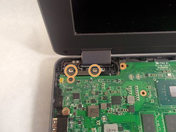

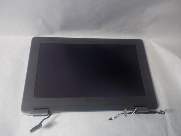

  11. Asus Chromebook C213SA-YS02 LCD Screen Assembly Replacement, LCD Screen Assembly: crwdns2935265:011crwdnd2935265:01crwdnd2935265:03crwdne2935265:0 Asus Chromebook C213SA-YS02 LCD Screen Assembly Replacement, LCD Screen Assembly: crwdns2935265:011crwdnd2935265:02crwdnd2935265:03crwdne2935265:0 Asus Chromebook C213SA-YS02 LCD Screen Assembly Replacement, LCD Screen Assembly: crwdns2935265:011crwdnd2935265:03crwdnd2935265:03crwdne2935265:0
    • Remove the two 4mm Phillips #00 stainless steel screws on one of the hinges.
    • Repeat the last step for the opposite hinge.
    • Carefully remove the LCD assembly off of the back plate. Be careful not to tug the LCD cable.
