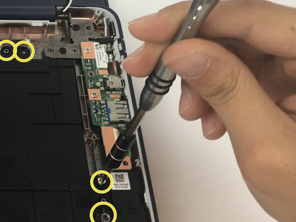

  10. Asus Chromebook C202 Motherboard Replacement, Motherboard: crwdns2935265:010crwdnd2935265:01crwdnd2935265:01crwdne2935265:0
    • Unscrew one 3 mm Phillips #1 screw.
    • Unscrew one 2.5 mm Phillips #1 screw.
    • Unscrew four 4 mm Phillips #1 screws.
