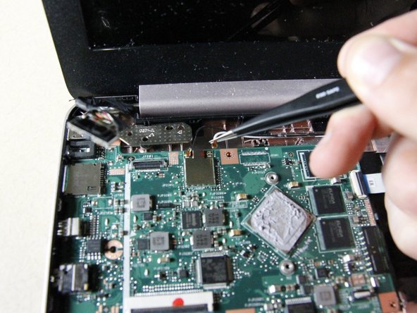

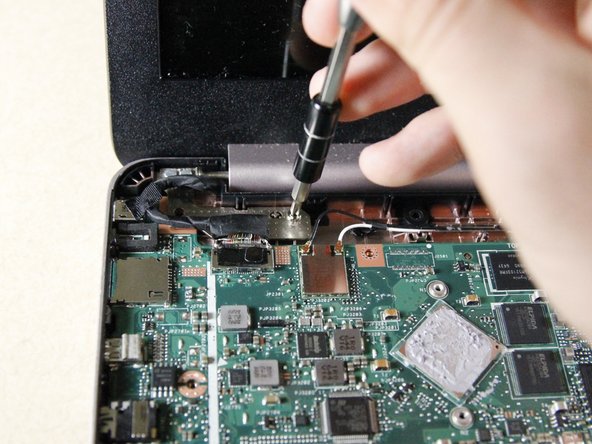

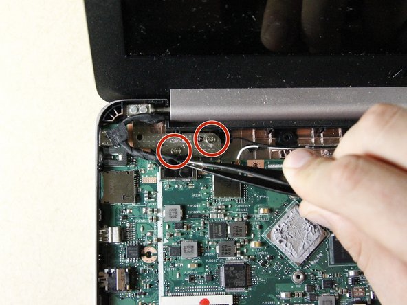

  7. Asus Chromebook C201PA-DS02-LG Screen Replacement, Screen: crwdns2935265:07crwdnd2935265:01crwdnd2935265:03crwdne2935265:0 Asus Chromebook C201PA-DS02-LG Screen Replacement, Screen: crwdns2935265:07crwdnd2935265:02crwdnd2935265:03crwdne2935265:0 Asus Chromebook C201PA-DS02-LG Screen Replacement, Screen: crwdns2935265:07crwdnd2935265:03crwdnd2935265:03crwdne2935265:0
    • Unscrew the 4mm screws with a Phillips #0 screwdriver by rotating the screwdriver counterclockwise.
    • There is a screw that is hidden under the black tarped connection that connects the screen to the motherboard.

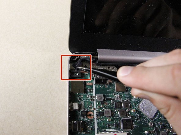

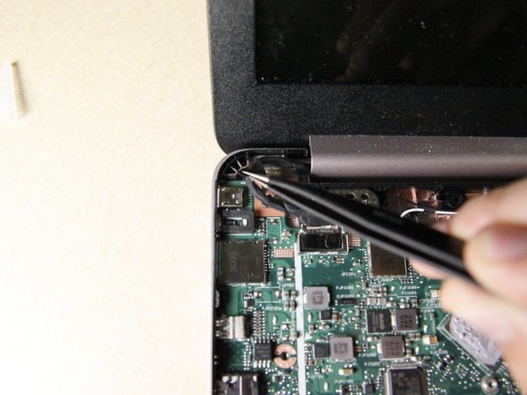

  8. Asus Chromebook C201PA-DS02-LG Screen Replacement: crwdns2935265:08crwdnd2935265:01crwdnd2935265:03crwdne2935265:0 Asus Chromebook C201PA-DS02-LG Screen Replacement: crwdns2935265:08crwdnd2935265:02crwdnd2935265:03crwdne2935265:0 Asus Chromebook C201PA-DS02-LG Screen Replacement: crwdns2935265:08crwdnd2935265:03crwdnd2935265:03crwdne2935265:0
    • Lift the tarp material straight up off the external output using tweezers. It is simply taped on.
  9. Asus Chromebook C201PA-DS02-LG Screen Replacement: crwdns2935265:09crwdnd2935265:01crwdnd2935265:03crwdne2935265:0 Asus Chromebook C201PA-DS02-LG Screen Replacement: crwdns2935265:09crwdnd2935265:02crwdnd2935265:03crwdne2935265:0 Asus Chromebook C201PA-DS02-LG Screen Replacement: crwdns2935265:09crwdnd2935265:03crwdnd2935265:03crwdne2935265:0
    • Use a pair of tweezers to grip the tarped connector and lift vertically up. It may help to do this on each side of the attachment, rather than in one pull.
    • Lifting the tarped connector straight up may feel like you are breaking it, but this is normal.

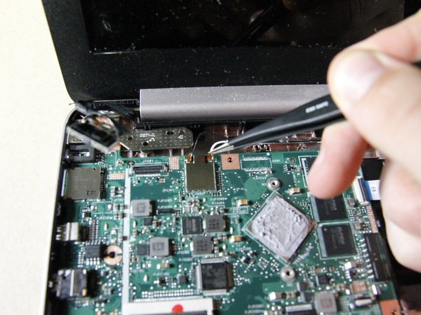

  10. Asus Chromebook C201PA-DS02-LG Screen Replacement: crwdns2935265:010crwdnd2935265:01crwdnd2935265:03crwdne2935265:0 Asus Chromebook C201PA-DS02-LG Screen Replacement: crwdns2935265:010crwdnd2935265:02crwdnd2935265:03crwdne2935265:0 Asus Chromebook C201PA-DS02-LG Screen Replacement: crwdns2935265:010crwdnd2935265:03crwdnd2935265:03crwdne2935265:0
    • Pop these two connections off by using tweezers to lift straight up.
  11. Asus Chromebook C201PA-DS02-LG Screen Replacement: crwdns2935265:011crwdnd2935265:01crwdnd2935265:01crwdne2935265:0
    • Lift the screen up to fully remove.
