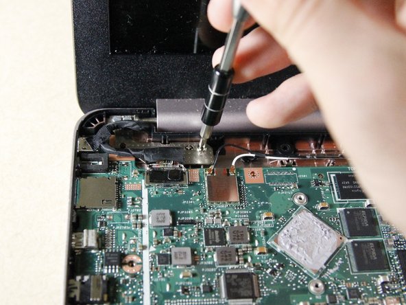

    • Use a Phillips #0 screwdriver to unscrew the 4mm screw. Rotate the screwdriver in a counterclockwise direction to undo the screw.

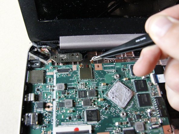

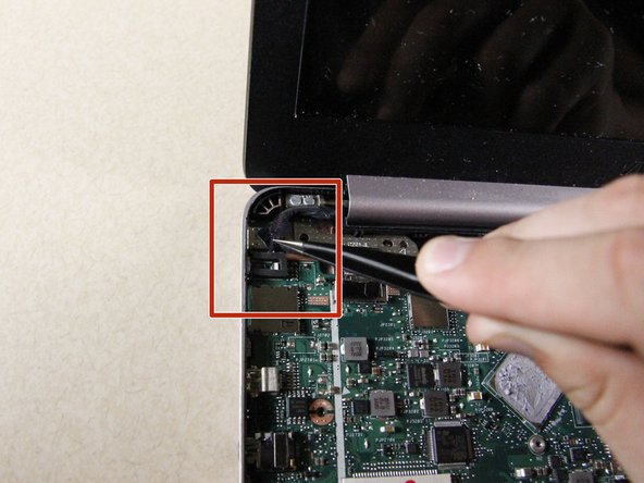

    • Use tweezers to gently pull upward on the adhesive black tape.
  9. Asus Chromebook C201PA-DS02-LG Motherboard Replacement: crwdns2935265:09crwdnd2935265:01crwdnd2935265:03crwdne2935265:0 Asus Chromebook C201PA-DS02-LG Motherboard Replacement: crwdns2935265:09crwdnd2935265:02crwdnd2935265:03crwdne2935265:0 Asus Chromebook C201PA-DS02-LG Motherboard Replacement: crwdns2935265:09crwdnd2935265:03crwdnd2935265:03crwdne2935265:0

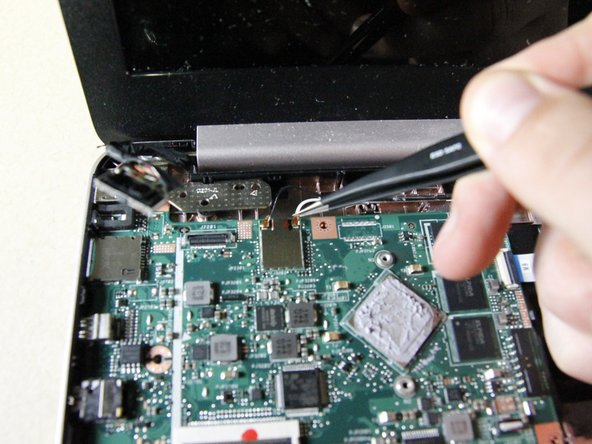

    • Use tweezers to pull upward and pop off the wifi antenna cables.
    • Removing the cables may cause popping noises.

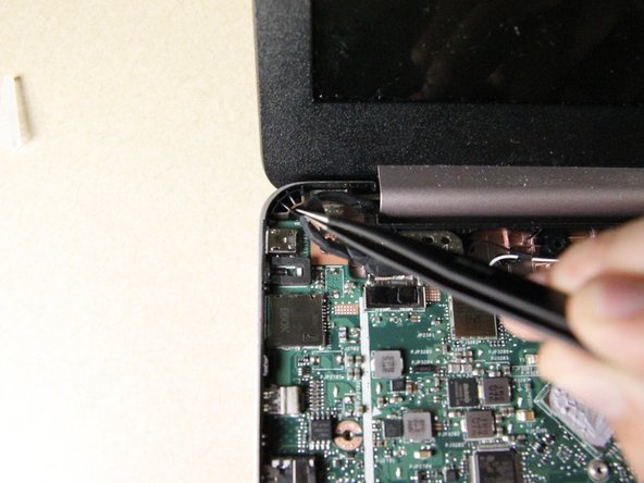

  10. Asus Chromebook C201PA-DS02-LG Motherboard Replacement: crwdns2935265:010crwdnd2935265:01crwdnd2935265:03crwdne2935265:0 Asus Chromebook C201PA-DS02-LG Motherboard Replacement: crwdns2935265:010crwdnd2935265:02crwdnd2935265:03crwdne2935265:0 Asus Chromebook C201PA-DS02-LG Motherboard Replacement: crwdns2935265:010crwdnd2935265:03crwdnd2935265:03crwdne2935265:0
    • Use tweezers to gently pull upward and pop off the LCD cable. It may help to do this on each side of the attachment, rather than in one pull.
    • Removing the cable may cause popping noises.

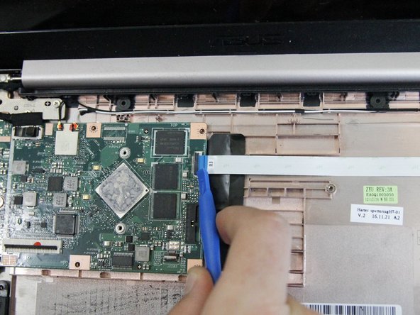

    • Flip up the white bar that connects the thin white strip using a plastic opening tool.
    • Grab the thin white strip and pull straight back to remove the strip from the connector.

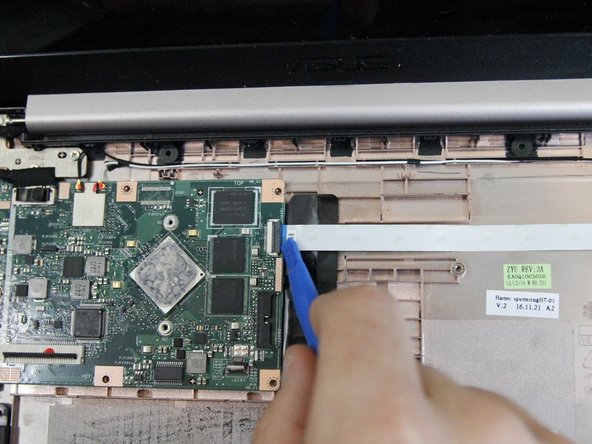

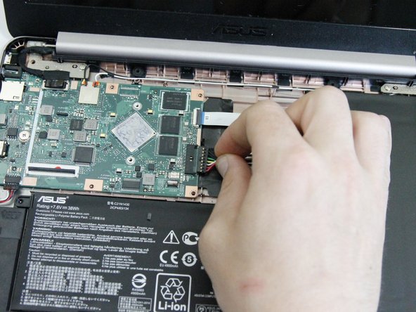

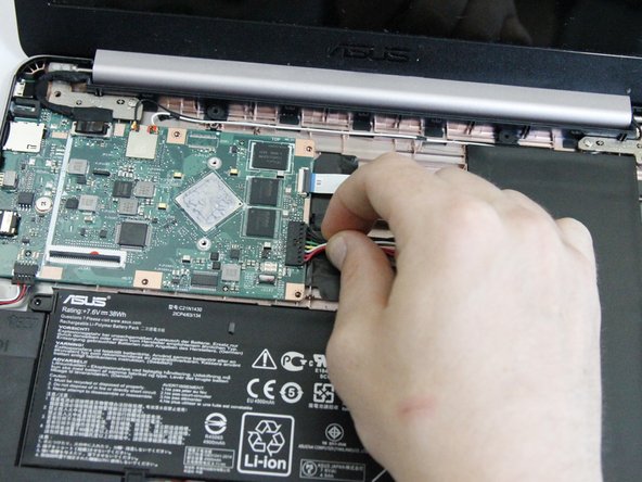

  12. Asus Chromebook C201PA-DS02-LG Motherboard Replacement: crwdns2935265:012crwdnd2935265:01crwdnd2935265:03crwdne2935265:0 Asus Chromebook C201PA-DS02-LG Motherboard Replacement: crwdns2935265:012crwdnd2935265:02crwdnd2935265:03crwdne2935265:0 Asus Chromebook C201PA-DS02-LG Motherboard Replacement: crwdns2935265:012crwdnd2935265:03crwdnd2935265:03crwdne2935265:0
    • Remove the rainbow connector by firmly grasping the rainbow wires and pulling straight back. It will help to brace the motherboard when you pull.

  14. Asus Chromebook C201PA-DS02-LG Motherboard Replacement: crwdns2935265:014crwdnd2935265:01crwdnd2935265:02crwdne2935265:0 Asus Chromebook C201PA-DS02-LG Motherboard Replacement: crwdns2935265:014crwdnd2935265:02crwdnd2935265:02crwdne2935265:0
    • Use a Phillips #0 screwdriver to unscrew the 4mm screws. Rotate the screwdriver in a counterclockwise direction to undo the screws.
    • One of the screws may be hidden underneath the black LCD connector.
