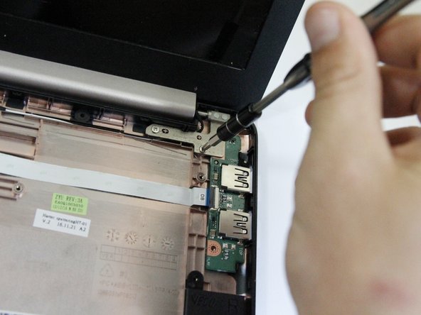

  7. Asus Chromebook C201PA-DS02-LG Daughterboard Replacement, Daughterboard: crwdns2935265:07crwdnd2935265:01crwdnd2935265:02crwdne2935265:0 Asus Chromebook C201PA-DS02-LG Daughterboard Replacement, Daughterboard: crwdns2935265:07crwdnd2935265:02crwdnd2935265:02crwdne2935265:0
    • Use a Phillips #0 screwdriver to unscrew the two 4mm screws.
    • Flip up the white tab to remove the white ribbon cable.

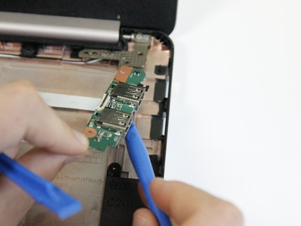

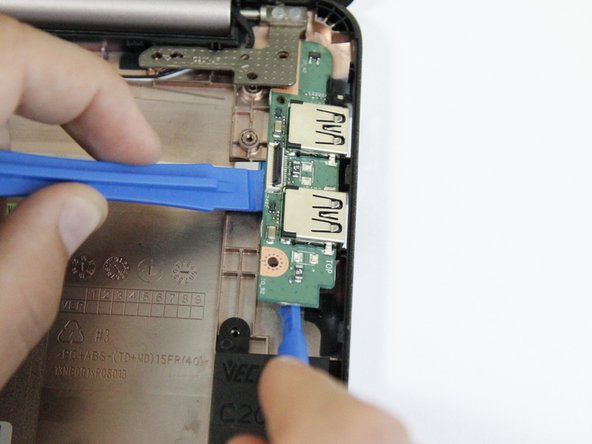

  9. Asus Chromebook C201PA-DS02-LG Daughterboard Replacement: crwdns2935265:09crwdnd2935265:01crwdnd2935265:03crwdne2935265:0 Asus Chromebook C201PA-DS02-LG Daughterboard Replacement: crwdns2935265:09crwdnd2935265:02crwdnd2935265:03crwdne2935265:0 Asus Chromebook C201PA-DS02-LG Daughterboard Replacement: crwdns2935265:09crwdnd2935265:03crwdnd2935265:03crwdne2935265:0
    • Place the plastic opening tools underneath the daughterboard.
    • Gently lift the daughterboard from the base of the device.
