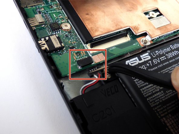

  12. Asus Chromebook C201 Motherboard Replacement: crwdns2935265:012crwdnd2935265:01crwdnd2935265:01crwdne2935265:0
    • Use the tweezers to disconnect the battery cable from the motherboard.
