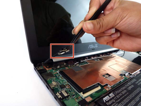

    • Locate the LCD cable and its connector which is located in the upper left hand corner of the computer. Carefully flip up the tiny tab and safely remove the cable using precision tweezers.

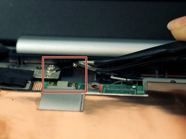

    • Disconnect the black and white cables located near the screen hinge.

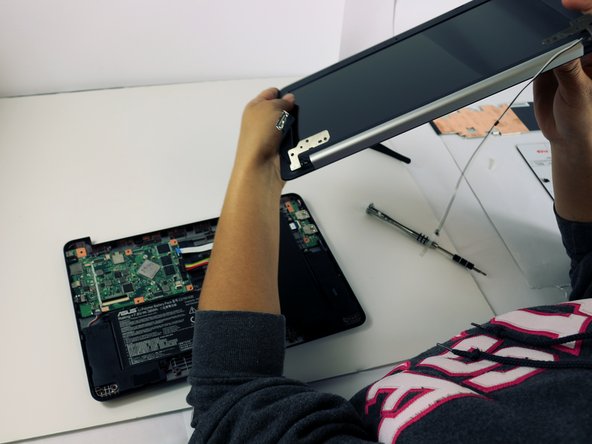

  13. Asus Chromebook C201 LCD Screen Replacement: crwdns2935265:013crwdnd2935265:01crwdnd2935265:02crwdne2935265:0 Asus Chromebook C201 LCD Screen Replacement: crwdns2935265:013crwdnd2935265:02crwdnd2935265:02crwdne2935265:0
    • Carefully pop the LCD screen assembly out of the laptop case.
  14. Asus Chromebook C201 LCD Screen Replacement: crwdns2935265:014crwdnd2935265:01crwdnd2935265:02crwdne2935265:0 Asus Chromebook C201 LCD Screen Replacement: crwdns2935265:014crwdnd2935265:02crwdnd2935265:02crwdne2935265:0

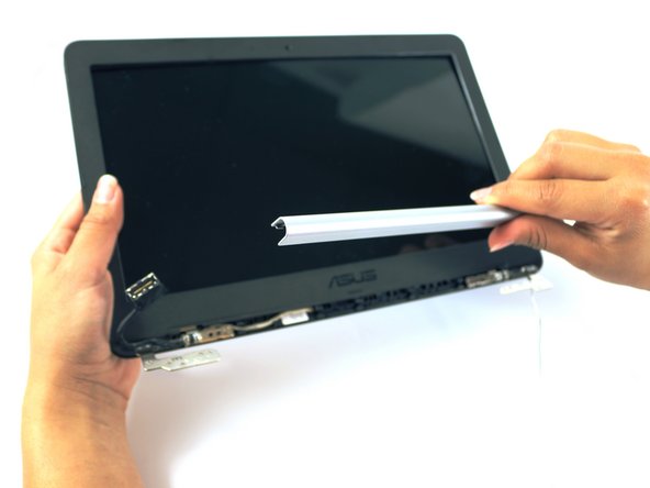

    • Remove the silver cover.
    • Make sure to put the cover back in right side (longer side) up when re-installing
  15. Asus Chromebook C201 LCD Screen Replacement: crwdns2935265:015crwdnd2935265:01crwdnd2935265:02crwdne2935265:0 Asus Chromebook C201 LCD Screen Replacement: crwdns2935265:015crwdnd2935265:02crwdnd2935265:02crwdne2935265:0

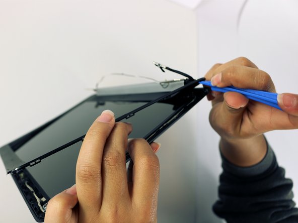

    • Use a blue plastic spudger to snap the LCD cover off, working the spudger around the perimeter and completely remove the cover.

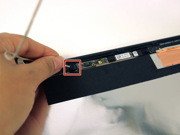

    • Remove the 4, 3mm silver corner screws holding in the LCD.
  17. Asus Chromebook C201 LCD Screen Replacement: crwdns2935265:017crwdnd2935265:01crwdnd2935265:02crwdne2935265:0 Asus Chromebook C201 LCD Screen Replacement: crwdns2935265:017crwdnd2935265:02crwdnd2935265:02crwdne2935265:0

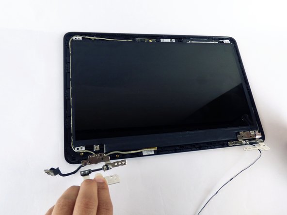

    • Remove the left hinge by unscrewing the two 3mm large Phillips head screws.
    • Unscrew the one 3mm small Phillips head screw.
  18. Asus Chromebook C201 LCD Screen Replacement: crwdns2935265:018crwdnd2935265:01crwdnd2935265:02crwdne2935265:0 Asus Chromebook C201 LCD Screen Replacement: crwdns2935265:018crwdnd2935265:02crwdnd2935265:02crwdne2935265:0
    • Carefully lift the screen. Gently unravel and unplug the LCD cord.
