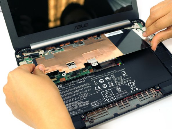

  9. Asus Chromebook C201 Battery Replacement, Battery: crwdns2935265:09crwdnd2935265:01crwdnd2935265:02crwdne2935265:0 Asus Chromebook C201 Battery Replacement, Battery: crwdns2935265:09crwdnd2935265:02crwdnd2935265:02crwdne2935265:0
    • Use a J0 screwdriver to remove the seven 4mm silver heat shield screws and remove the heat shield.
  10. Asus Chromebook C201 Battery Replacement: crwdns2935265:010crwdnd2935265:01crwdnd2935265:01crwdne2935265:0
    • Pull the battery cable from the motherboard.
  11. Asus Chromebook C201 Battery Replacement: crwdns2935265:011crwdnd2935265:01crwdnd2935265:01crwdne2935265:0
    • Use a J0 Phillips screwdriver to remove the 5, 4mm silver battery screws from the battery.
  12. Asus Chromebook C201 Battery Replacement: crwdns2935265:012crwdnd2935265:01crwdnd2935265:01crwdne2935265:0
    • Grab the the battery and remove it from the Chromebook.

This was a great guide to replacing the battery in the ASUS chromebook C201 PA. I left the instructions displayed on my regular lap top as I went thru the steps. There was a trick when it came to disconnecting the keyboard plugs. The tabs that were supposed to be bent up to enable the unplugging weren’t there and rather than fiddle around trying to unplug them in some other way I just left them connected and manipulated the key board very carefully when needed. A second set of steady hands can help.
Doug Hooper - crwdns2934203:0crwdne2934203:0
I first looked for a YouTube video for info, silly me. They showed removing the lid and disconnecting all the accompanying cables! It didn’t look necessary to me, and as this guide shows, it isn’t.
I do find it curious as it looks to me like the lid is lying flat, I wonder if the author loosened or removed the lid hinge screws to allow that. That might simplify things.
The battery failed in mine, I’m debating whether or not it’s worthwhile to replace in a five year old device that cost $200ish to originally purchase.
