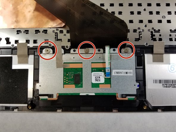

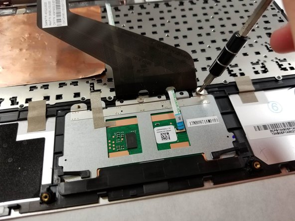

  6. Asus Chromebook C101P Touchpad Replacement, Touchpad: crwdns2935265:06crwdnd2935265:01crwdnd2935265:03crwdne2935265:0 Asus Chromebook C101P Touchpad Replacement, Touchpad: crwdns2935265:06crwdnd2935265:02crwdnd2935265:03crwdne2935265:0 Asus Chromebook C101P Touchpad Replacement, Touchpad: crwdns2935265:06crwdnd2935265:03crwdnd2935265:03crwdne2935265:0
    • Remove the three Phillips #0 screws holding the trackpad in place.
