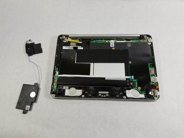

  6. Asus Chromebook C101P Speakers Replacement, Speakers: crwdns2935265:06crwdnd2935265:01crwdnd2935265:01crwdne2935265:0
    • Remove the four Phillips #0 screws from the speakers.
  7. Asus Chromebook C101P Speakers Replacement: crwdns2935265:07crwdnd2935265:01crwdnd2935265:01crwdne2935265:0
    • Remove the yellow speaker tape using tweezers.
  8. Asus Chromebook C101P Speakers Replacement: crwdns2935265:08crwdnd2935265:01crwdnd2935265:02crwdne2935265:0 Asus Chromebook C101P Speakers Replacement: crwdns2935265:08crwdnd2935265:02crwdnd2935265:02crwdne2935265:0
    • Detach the right speaker using tweezers.
    • The right speaker has its own set of cables connecting to the motherboard. Simply tug on the cables.
