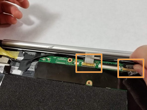

  6. Asus Chromebook C101P Screen Replacement, Screen: crwdns2935265:06crwdnd2935265:01crwdnd2935265:02crwdne2935265:0 Asus Chromebook C101P Screen Replacement, Screen: crwdns2935265:06crwdnd2935265:02crwdnd2935265:02crwdne2935265:0
    • Detach the the screen cables from the motherboard using a pair of tweezers.
    • Peel off the tape or seal to easily remove the screen cables.

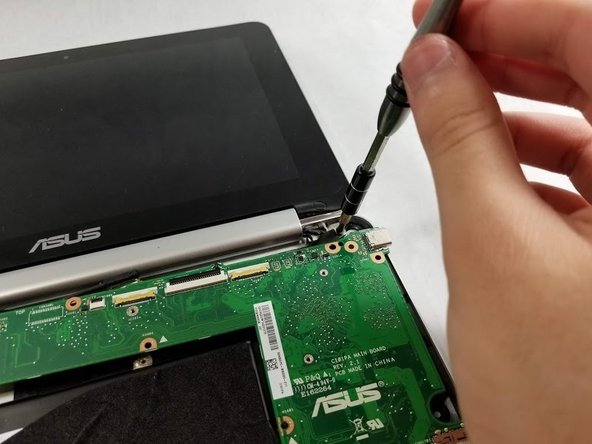

  7. Asus Chromebook C101P Screen Replacement: crwdns2935265:07crwdnd2935265:01crwdnd2935265:02crwdne2935265:0 Asus Chromebook C101P Screen Replacement: crwdns2935265:07crwdnd2935265:02crwdnd2935265:02crwdne2935265:0
    • Remove the Phillips 00 screws from the hinges.
  8. Asus Chromebook C101P Screen Replacement: crwdns2935265:08crwdnd2935265:01crwdnd2935265:01crwdne2935265:0
    • Angle the hinge as shown and use a T5 Torx screwdriver to remove the hinge screws.

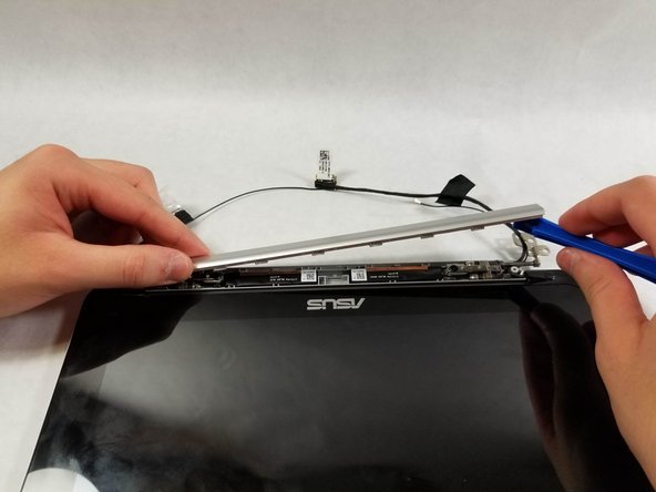

  9. Asus Chromebook C101P Screen Replacement: crwdns2935265:09crwdnd2935265:01crwdnd2935265:02crwdne2935265:0 Asus Chromebook C101P Screen Replacement: crwdns2935265:09crwdnd2935265:02crwdnd2935265:02crwdne2935265:0
    • Pry open the hinge by using the iFixit opening tool.

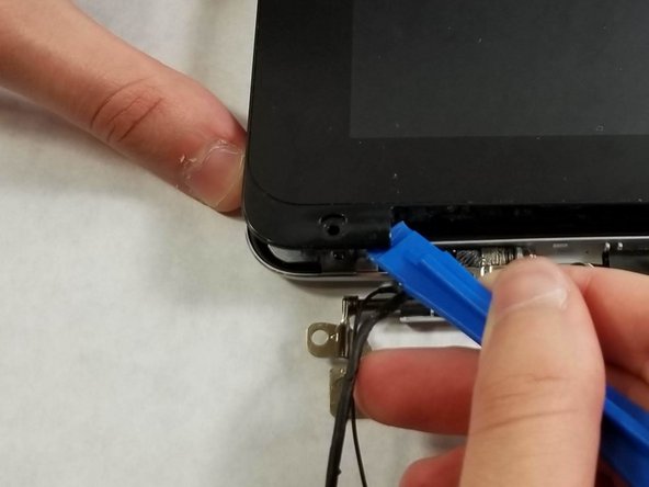

  11. Asus Chromebook C101P Screen Replacement: crwdns2935265:011crwdnd2935265:01crwdnd2935265:03crwdne2935265:0 Asus Chromebook C101P Screen Replacement: crwdns2935265:011crwdnd2935265:02crwdnd2935265:03crwdne2935265:0 Asus Chromebook C101P Screen Replacement: crwdns2935265:011crwdnd2935265:03crwdnd2935265:03crwdne2935265:0
    • Use the iFixit opening tool to pry around the screen.
    • Use the space between the screen and the hinge to prop it up.
    • Once open, slide the wires that are in the hinge out. The screen should now be fully detached from the case.
