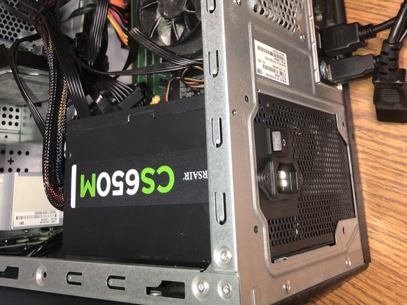

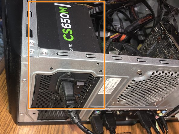

  3. Asus CM1745 Power Supply Unit Replacement, Power Supply: crwdns2935265:03crwdnd2935265:01crwdnd2935265:02crwdne2935265:0 Asus CM1745 Power Supply Unit Replacement, Power Supply: crwdns2935265:03crwdnd2935265:02crwdnd2935265:02crwdne2935265:0
    • Locate the power supply unit which was connected to the cable unplugged in Step 1.

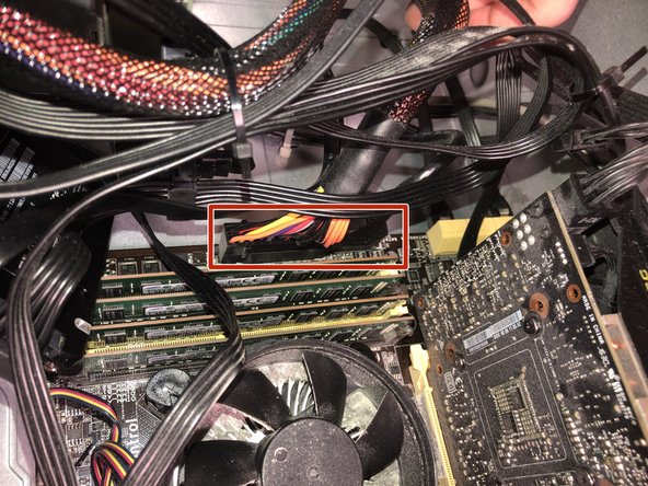

  5. Asus CM1745 Power Supply Unit Replacement, PSU Cables: crwdns2935265:05crwdnd2935265:01crwdnd2935265:02crwdne2935265:0 Asus CM1745 Power Supply Unit Replacement, PSU Cables: crwdns2935265:05crwdnd2935265:02crwdnd2935265:02crwdne2935265:0
    • Unplug all attached cables from the Power Supply, then unplug the cable attached to the Motherboard inside the PC.
  6. Asus CM1745 Power Supply Unit Replacement, Replacement: crwdns2935265:06crwdnd2935265:01crwdnd2935265:02crwdne2935265:0 Asus CM1745 Power Supply Unit Replacement, Replacement: crwdns2935265:06crwdnd2935265:02crwdnd2935265:02crwdne2935265:0
    • Once unplugged, you can plug in the cables into the new Power Supply and Motherboard.
