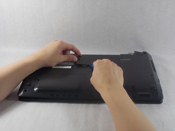

    • Make sure the laptop is off.
    • Flip the laptop upside down so that the battery is facing you.
  2. Asus A53U-ES21 Wireless Card Replacement: crwdns2935265:02crwdnd2935265:01crwdnd2935265:02crwdne2935265:0 Asus A53U-ES21 Wireless Card Replacement: crwdns2935265:02crwdnd2935265:02crwdnd2935265:02crwdne2935265:0
    • Move the two sliders towards the outer edge of the laptop.
    • Pull the battery out with your left hand while holding the right slider.

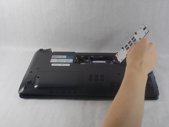

    • Remove the 5mm screw using a Phillips #1 screwdriver.
    • Use the iFixit opening tools to remove the panel.

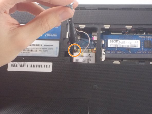

    • Detach the two cables connected to the wireless card (the opening tool works well for this).
    • Remove the 4mm screw (highlighted in orange).

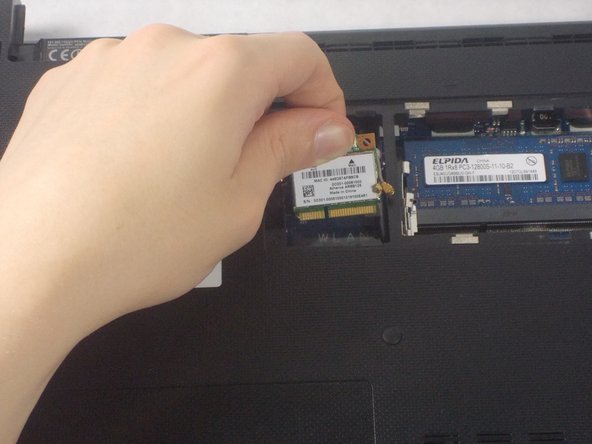

    • Pull the wireless card up and remove it from the device.
